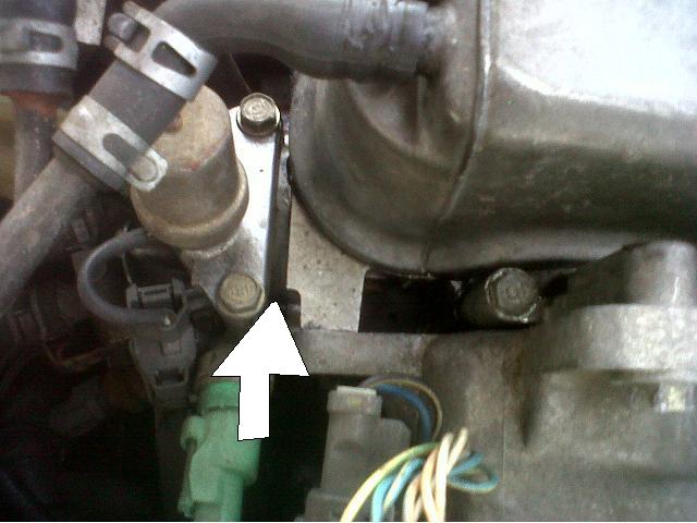

I have a 93 Civic EX that's turned into a sieve for the oil I put in. I found where the oil is coming from but have no idea what it's called or if there is a gasked there that I can change. In the included picture the oil leak is coming from where the arrow is pointing. On the right is the valve cover but I don't know what is on the left and if there a gasket in between them that I can change out?

VTEC valve. There are 2 gaskets that commonly leak, #13 and #15.

The part I was referring to is called the vtec solenoid and I found the gaskets, that was pretty easy. The issue I ran into when I was trying to put everything back togethor was that the screws were pretty tight when I got them out. So when I was installing them I cranked down on them and ended up breaking a corner off the part that sits on top.
I found out that the screws were tight when I was taking them off because they had some white lock tight on them and according to the dealership they are only supposed to get 9lbs torque on the screws anyway. Well I have 2 questions now: 1) can I get the part that broke off welded back on? 2) if I can't get it welded I found a junk yard that has a very similar part that comes from a 94 EX, would I be able to use that one if the holes line up properly?

Look up both of them, see if the part numbers are the same.
