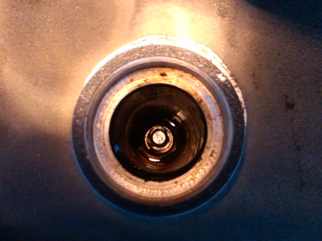

Edit: I came home today and as I was pulling into the drive my civic sputtered and stalled out. I finally was able to get it restarted after a few failed attempts. During the restart it would turn over, but would stay cranked. I tried one last time and gave it a little gas with the pedal and this time it sputtered to life, but was running rough.
I pulled it into my garage and began to change out the plug wires (I realized I didn't have the extension or socket needed to change the plugs). As I removed the old plug wires and looked down into the the spark plug well I noticed what I think is a rather large amount of oil on top of the plugs. Anyone have thoughts on that? Should I be worried?
I've included a pic.

That is likely your problem, but not definitely. Common with these cars, though. I most recently replaced my gasket and Permatexed it. I first cleaned all surfaces including gasket with acetone, and then after Permatexing, I let it cure for a day. Now it's leak-free.
The oil has carbon, which conducts electricity. It's most difficult to produce a spark at high speeds and/or under high load, so the spark will choose the path of least resistance.
If this doesn't solve the problem, consider the ignitor or main relay or something of that nature.
If acceleration is smooth, you can probably rule out the TPS. A worn TPS can cause bucking.
I think that my spark plug wires are the original ones. I check the resistance and clean them in soap and water and allow them to dry. If very dirty, I clean the soot and grime off with acetone. If you doubt yours, though, then perhaps buy a new set.
Hopefully your timing belt was put on correctly, though I can't see that affecting only a certain speed.

When the spark plug holes fill with oil, it is usually caused by the rocker stand seals (not the vc gasket and plug tube seals). #16 and #17 in this pic. The 4 rubber seals will be hardened and brittle.
http://www.hondaautomotiveparts.com/...=CYLINDER+HEAD
HTH

Oh. I see now what you are talking about. Hopefully a VC seal is all that is needed, and the OP doesn't have to dig in that far.
Every time I have had oil leak into the spark plug wells, however, a valve cover gasket repair was all that was needed. This last re-gasket including Permatex has left my plug wells absolutely dry.
Of course noting where the oil originates from, that is whether it runs all the way up the plug well or not, will determine which gasket is leaking.
