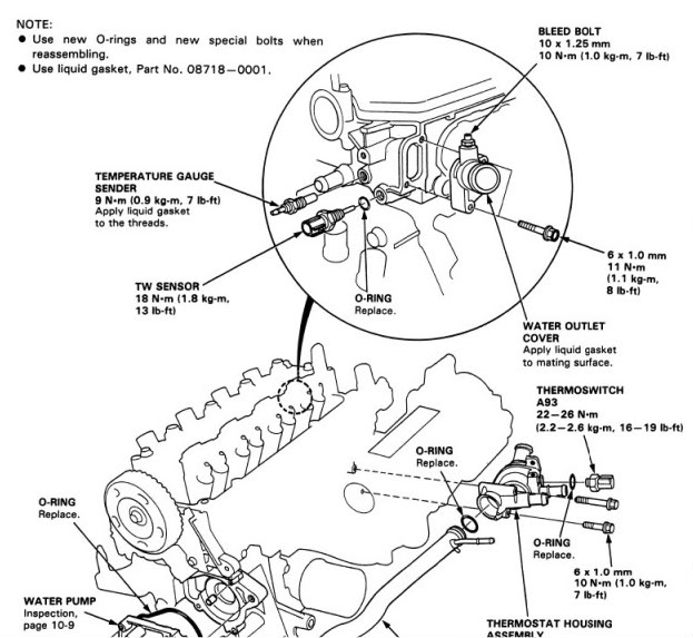

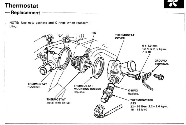

I haven't been able to check it because I can't seem to find it. Where would it be exactly?

It's the thermoswitch, right? What is the TW sensor? Where is it exactly? It looks like the lower left front of the motor if we're talking about the TW sensor, or the lower left back if we're talking about the thermoswitch. If that's the case, I'm gonna have to jack the car up.
