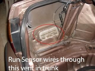

6 - Get in the trunk and take out the drivers side panels so you can see. On the sidewall, there is a vent that leads outside of the car, this is where you will feed in the wires. It's big and shouldn't be hard to find, it's about 6 inches by 4 inches at least, but it is all black so it might take a second to spot it. It's easy to reach around in that area, nothing is obstructing your access beside the cloth panels.
7 - Get back under the car and feed the lines through the vent, one at a time, all at once, it helps to have a friend but I did it by myself just feeding them in slowly.

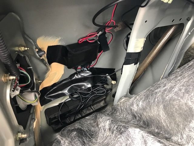

10 - Back in the trunk, plug all the wires in. Now plug in the sensor alarm. In my case, I just wanted the sound, so I simply wiretired the panel up in the corner near the backseat so I could hear it.
11 - At this point, find a place to tape the little box into place, It can be just taped to the floor. I also added tape to keep the wires plugged in.
Here is the controller installed, wires coming in from sensors through vent
Here is where I wiretied the monitor in the back of the trunk since I just wanted the beeping sound and didn't care about a monitor.
