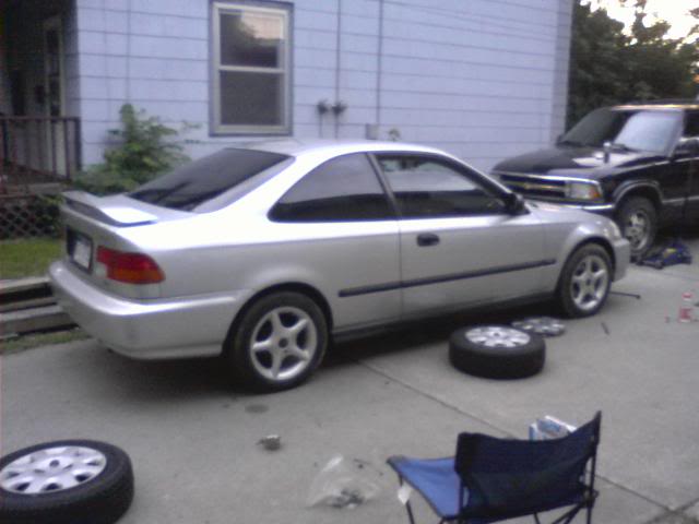

Below is my 1998 Honda Civic DX ive owned it for about six months and it is my first Honda ever. It's not fast but very stylish! I think I'm understanding alot about them just by reading what others have posted on this site. It has 155,000. belts and regular mant. has been done to it before i got her.
The best thing is about this Honda it only costed me $700.00 no ****
