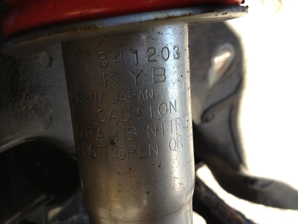

Here it is now with the wheels on:
I had taken a wheel off a while ago thinking I could just go back to OEM springs but I then realized the whole thing must have been replaced because OEM springs are 6" diameter and the ones on it are 4" diam. I am okay with keeping the KYB stuff I just need the ride height another 2" or so higher so it doesn't hit every bump on the road. The rear is only slightly lowered from stock though it seems to b e using the same kit as it has the same style and color springs and struts. Whoever did the work clearly screwed something up.

"OEM equivalent springs" I got to try to restore it... but they are too wide to fit.

When I replaced the shock, it was *extremely* difficult to remove the shock assembly from the fork after removing the required bolts. There wasn't nearly enough clearance. I had to have somebody stand on the wheel to pull down the control arm & axle far enough to be able to pull the shock up out of the fork. Re-installing the new one was just as hard. I was using a video of somebody doing a similar job and theirs just fell free basically, they did not have to pull the wheel down away from the body to get things on/off. Is it possible that the "knuckle" was replaced for some reason, or that the fork is non-stock? In the pictures your wheel seems to drop below parallel whereas min seems nearly parallel even when hanging free.
The knuckles say 'SOL L' and 'SOL R' for left and right which I think is stock as I see it elsewhere. You can see this in my first picture here, it appears to have been painted black when the suspension work was done. The control arms and such look original.
In any case it seems fine but I can't explain why there is so much resistance on the wheels to move downward.
