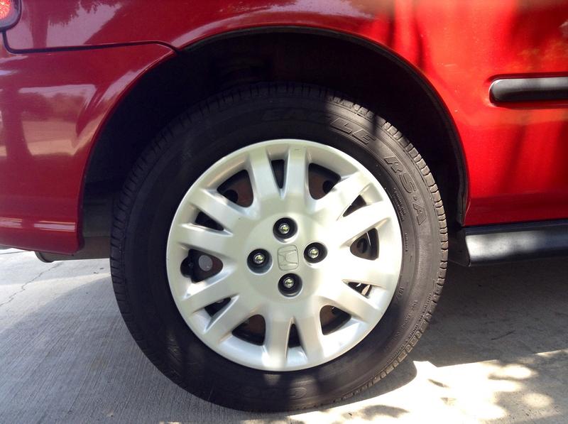

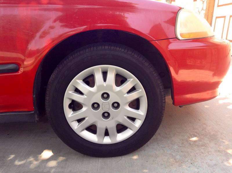

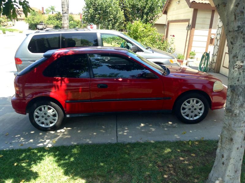

I have this here 1996 Honda Civic hatchback, I'd like to lower it, eliminate some wheel gap, give it a better look. This is my daily so I don't want to slam it to the floor, just lower it to make it look better. The tire size are 195 60R15 btw...The springs I was looking at were Tein S Techs, Eibach Pro, and Eibach sportlines, the strut i was looking at are the Koni STR T Orange shocks..im new to all this so please give me suggestions! I want to have 1-2 finger gap between the tire and fender

I had s techs and I liked the drop and ride, currently i have sportlines and they are not as low and ride is softer then s tech.
if I was to choose again i would definitely go for stechs, or do a combination like s tech in the front and sport line in the rear

i would snag some H&R lowering springs, great ride!
