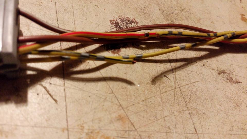

Here is the latest...I got a new actuator and hooked it up and it didn't work. When the new actuator is hooked up, the rest of the locks do not work. FOB or the driver's door control. When I unhook the new actuator, the rest of the locks work.
I hooked up a test light to the connector of the bad door and there was no light. I also did the light bulb test, as mentioned and it also did not light up.
What is my next step to figure out the power situation? Thank you.

Check the door harness for broken wires
Does the power window work?
