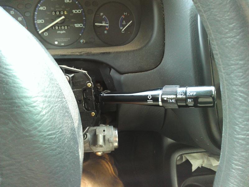

For a while now I have wanted to add variable speed intermittent wipers to my 99 EX. Whenever the rain is light it always seems like the intermittent speed is never the right one. I figured with all the modding and tuning going on out there in CivicLand someone else would have sorted this out by now and posted a sweet video tutorial complete with dancing girls. You know, something the average Joe DIY type can understand. Based on the many fruitless searches I have conducted I figured wrong.
However, I did find this, and it gave me hope:
http://www.cb7tuner.com/vbb/showthread.php?t=142965
The rocket scientist who posted that upgraded a 1990 Accord using a wiper switch from a CL and the Integrated Control Unit (ICU) from a 95 Accord. Hence, we know it can be done.
Still, having not found clear cut instructions on how to accomplish this on a Civic (can the ICU from a 95 Accord be used in any way shape or form on a 99 Civic?) , this still leaves the job to me, or to us, rather, as I haven't worked out how to do it either. But I am close. The first step, in my book, is replacing the wiper arm and that I have accomplished.
Parts used: the wiper arm from a 1998 Honda Accord that has the variable speed dial.
Tools used: one Phillips and one flat head screwdriver.
Summary: take apart the existing wiper switch arm assembly and replace just the arm/stalk using the arm from the Accord. The rest of it won't work with the existing Civic parts. In other words, the base and the contacts have to be from a Civic, but the arm comes from the Accord.
In the event this thread gets a lot of hits and requests I will post more detailed instructions for this, but I did exactly what the guy in the posted link did with his wiper arm, no filing required. Tested it out fine, wipers work exactly as they did before, except now I have the variable speed dial for the intermittent wipers.
Problem: that dial, while all pretty and stuff, doesn't work. It's not hooked up to anything. What do I hook it to? Does the ICU in the 99 Civic have variable speed capability, or do I need a different ICU? Full replacement or piggyback?
I know I'm not the first person to think of this so I look forward to the avalanche of input coming my way. Thanks in advance.
