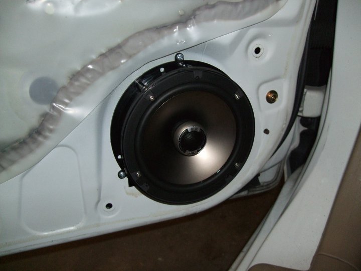

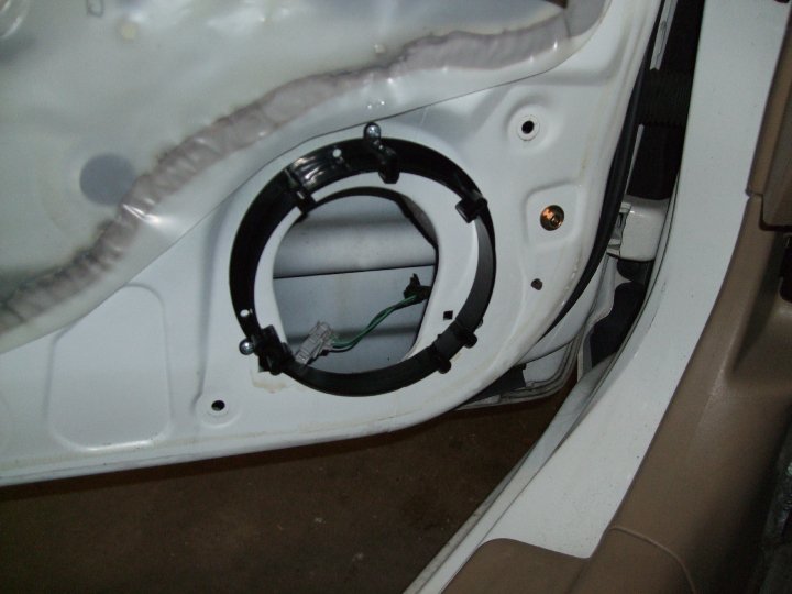

The reason why I say brackets, is so that you don't tear into your car and later on sell your car and decide to keep your speakers, but can't install stock speakers back on because you've widened the hole.
And brackets, because the hole where the magnet of the speaker goes in, is small.
Not small enough where the magnet wont fit, but rather, the metal frame of the speaker wont fit.
Another reason, is because you have the 6501; not the 651s (Shallow mount coaxial) that I have.
The magnet will extend far into door panel, where your model of civic should be the same as mine, where the door has a metal support behind it, not allowing you to fit the whole magnet in.
If the magnet goes too far back, and is too large, you may have issues with your windows going down and hitting the magnet as well.
Words can be meaningless, here is a photo of my install.
See the support bar inside the door?
These are my 651s coaxials

Thank you Kenny, for further explaining and more so for the photos, they really make things simple, clear, and completely comprehensible. It seems I was correct in my understanding that the brackets you were speaking of are the same, more or less, as spacer rings/brackets.
Now as for his inquiry about amp installation, you got any pointer specific for Civics, or any pointers you feel should be said in general, just in case?
I mean, for instance, how is the chassis to battery grounding on those cars? I ask as poor grounding is often the issue with amps not functioning properly. Are they notable for any specific issues when installing a system or anything? What kind of power does the alternator produce on those cars? I know imports tend to have far smaller alternators than domestic cars, so if he's planning to run some power hungry amps it'd be wise to upgrade the Big 3 and possibly the alternator.
The heads up with the speakers was of great help and a key point I'm sure, so again, thank you.

1) What bracket is that in the pictures and where can i get them?
These are Metra brackets that I used, go to www.metraonline.com to look for your specific part number.
Then prowl ebay for one, or purchase directly from Metra.

For some reason metra's website isn't showing speaker brackets when i plug the car in. Any idea what the part number is? Also, will the brackets cause door panel fit issues or will it still fit fine?
This would be the correct dash kit? --->

According to metra, yes thats the right kit.
And these should work.
They're pretty universal for 6.5" speakers.
http://www.ebay.com/itm/METRA-82-780...2ab30c&vxp=mtr
You will need to drill 3 small holes to attach the bracket (still better than widening the speaker hole) and 3 machine/self tapping screws.
I did have some slight fitment issues only because there was a plastic guard on the inside of the door panel where it covered the stock speaker.
It was easily removed with some pliers. (You will have to break it off the panel)
