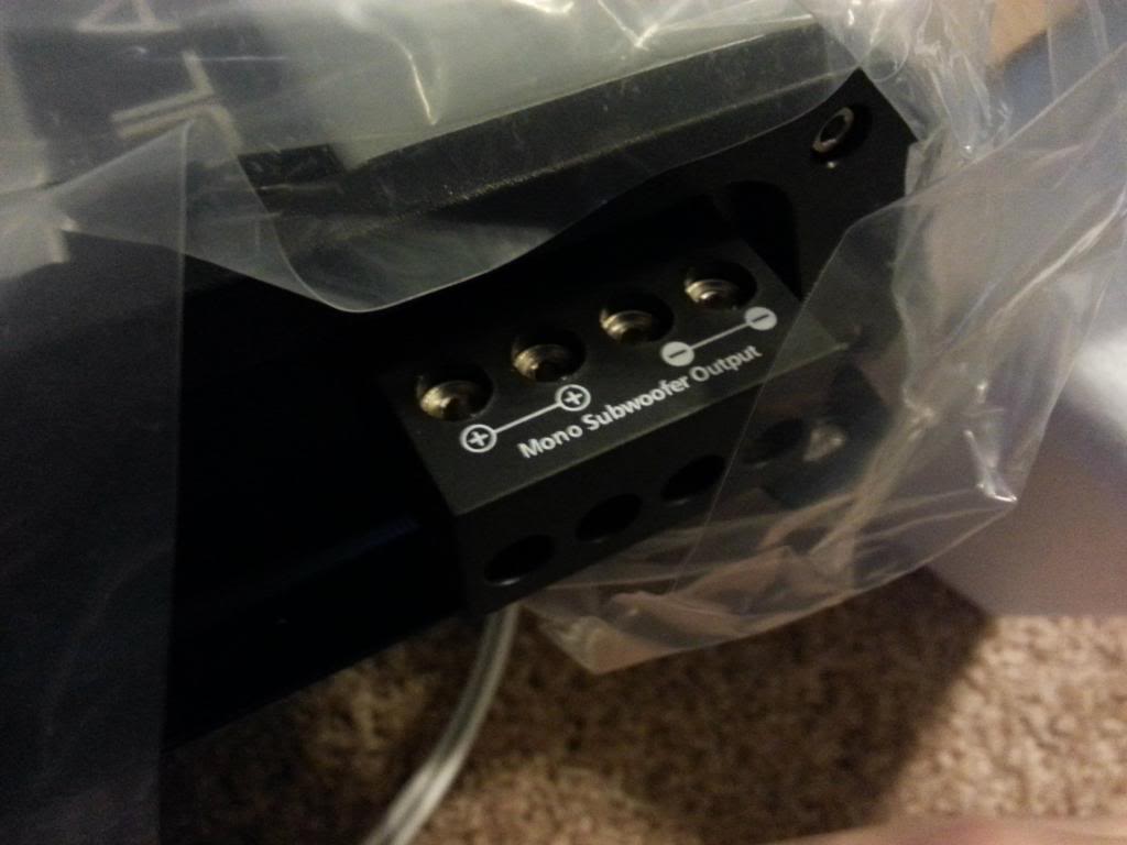

Wired it up as stated above...pretty straightforward.
On the amp there are two positive and two negative speaker wire terminals next to each other...see picture: (dont know why but the forum is posting my pictures upside down)
This was taken from the manual regarding this:
"SPEAKER OUTPUT
Subwoofer connection to the JX monoblock
is straightforward and takes place at the
far right of the power/speaker connection
panel. Two positive (%u201C+%u201D) connections and
two negative (%u201C%u2013%u201D) connections are available
via a connector labeled %u201CSpeaker Output
(Mono)%u201D. The dual connections allow for two
separate speaker wire runs to be parallelconnected
to the amplifier%u2019s mono output."
am i correct in understanding only one of each wire terminal will be used for my application? the extra two holes would be used if i was powering two subs from this mono block?
On a different note, does the 36" ground rule apply for the h\u?
Old Jan 10, 2013
  #114
Weigel21's Avatar
Joined: Dec 2012
Posts: 84
Weigel21 is an unknown quantity at this point
Re: New Stereo set up - Please Advise
"SPEAKER OUTPUT
Yep, the speaker terminals on the amp are wired in parallel internally, so it doesn't matter which + or - terminal you use. The two terminals are for, as you suspected, ease in wiring multiple subs to the amp. The user has to keep in mind that the terminals are wired in parallel and so it'd cut the load in half. Meaning two 4Ohm subs would present a 2 ohm load. In your case, the sub has two voice coils, you can look at this is it being two subs, but you are doing the parallel wiring at the sub, not the amp, so it'll see it as a 2 ohm load.
