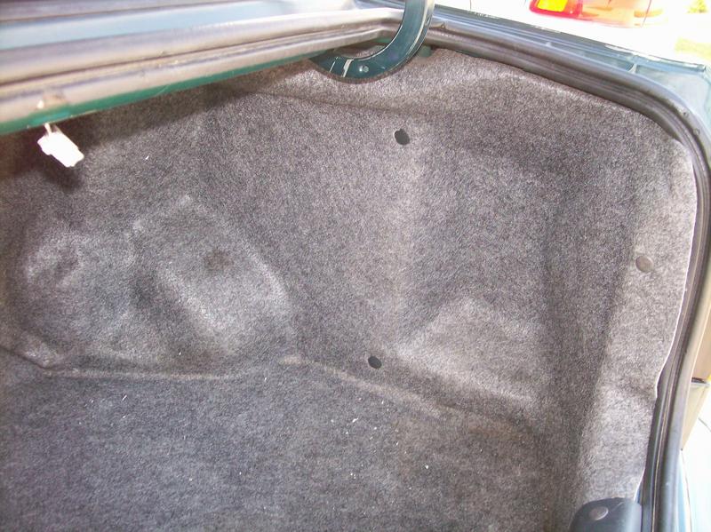

I am working on a stealth Civic sub woofer project and am hoping members here can answer a question for me. Im wondering if the trunk is the same for the 2 door and 4 door models? I have included some pictures of my 4 door trunk for reference. I also will be showing my progress of the box and how it fits. Thanks for any replies.

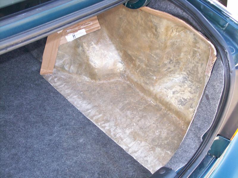

Here I am making the basic form that fits into the passengers side of the trunk. Basic idea is to have a sub thats out of the way and takes up as little trunk space as possible. It also lifts out of place in seconds in case I need all of my trunk space back. When the trunk lid is closed the trunk hinge holds the box in place. I am making this big enough for a single 12 inch sub woofer. I filled this form full of sand and then poured the sand into a box of known volume and came up with 1.7 cubic feet of air space,by the time I trim it and install the front baffle it will be around 1.6 cubic feet.

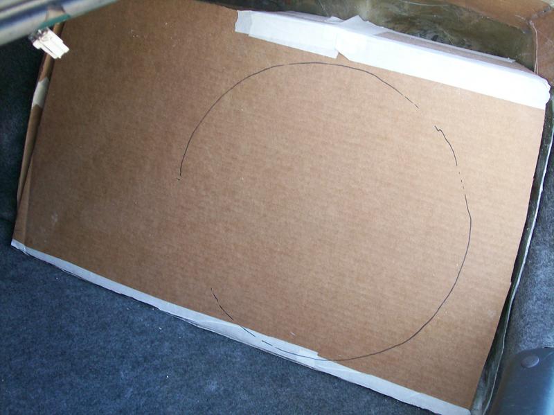

Here it is again with a cardboard front checking fitment before I spend the time making a mold. These are obviously going to be fiberglass and it takes forever to make the mold. The front panel is going to be flat and will be MDF.

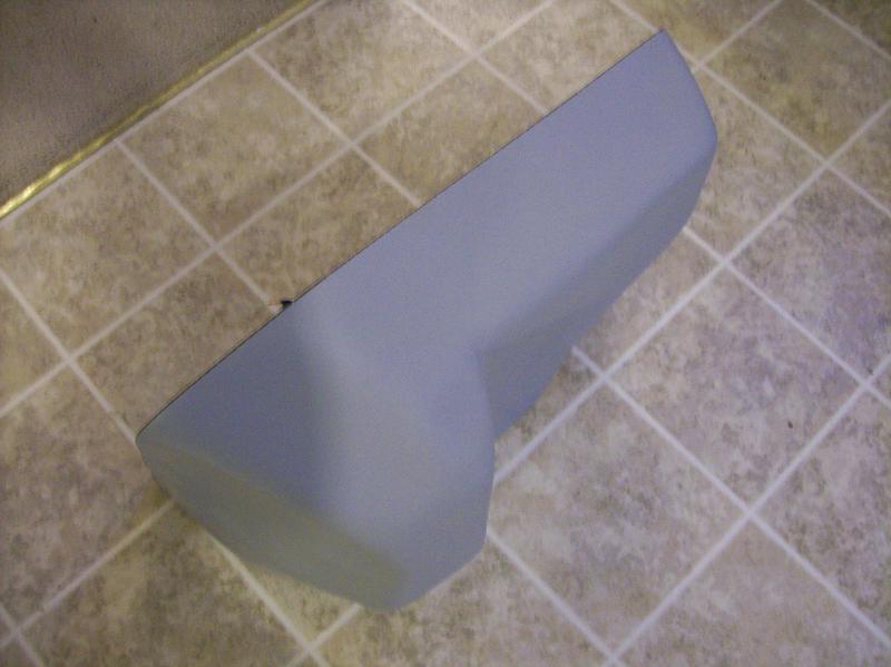

Well here is the first box sitting in place without a woofer. I didnt take pictures for a while and spared everyone the boring parts of making the mold and waiting for materials to come in the mail. It fits perfectly and takes up very little useable space in the trunk. Im also very happy with how the trunk hinge holds it in place when the lid is closed. I built a spare box and the mold is working out great but these are a lot of work. I painted the back of the box in a flat grey urethane car paint and covered the front with a black textured vinyl,very durable to take lots of abuse in the trunk. This has been going for several weeks even though everything is posted today.

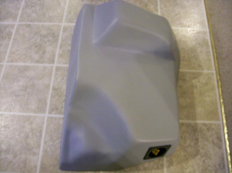

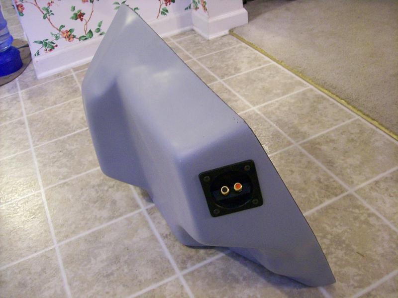

Here you can see how the back of the box if contoured to fit the side of the trunk. You can also see the terminal cup with gold connectors. The box ended up being quite solid with a thickness of 3/16 to 1/4 of fiberglass, plenty strong. I stood on the box and it didnt flex under my weight of 175 lbs. I made a mold so I can build extra boxes and sell them on ebay.

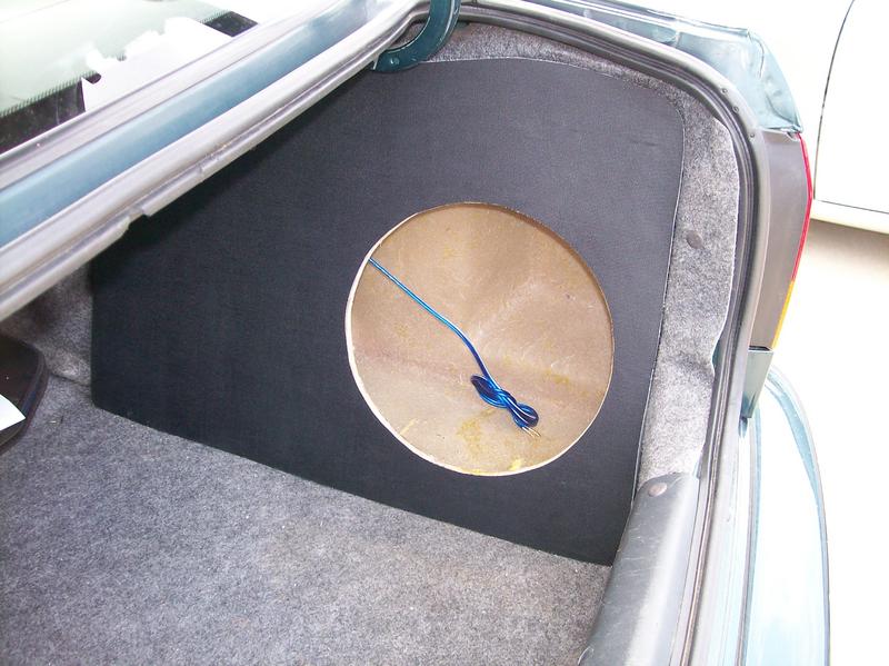

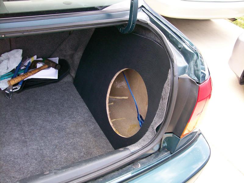

Im asking if anyone knows if the trunk is the same for the 2 and 4 door civics? This will fit 1996 to 2000 civics that are 4 door models Im just not sure about the 2 door models? Here is more shots of the trunk. If anyone knows a answer to this please let me know. Appreciate the responses.

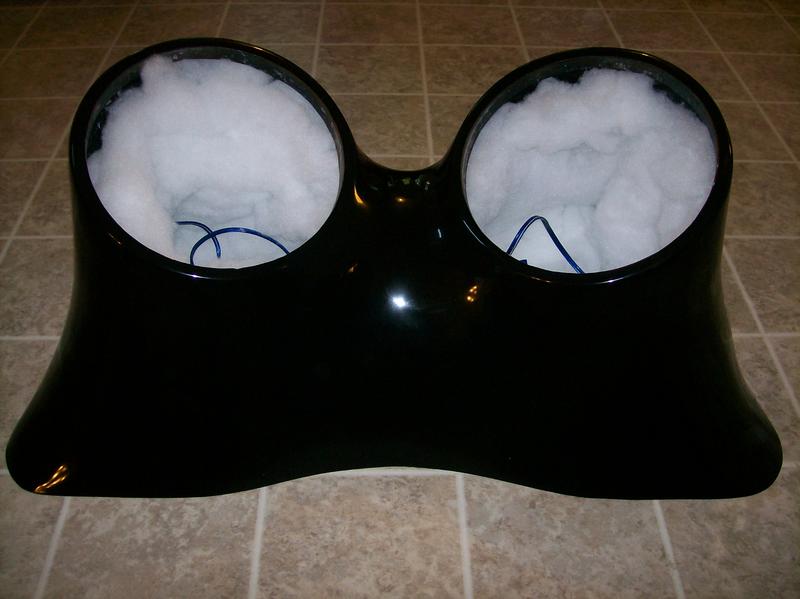

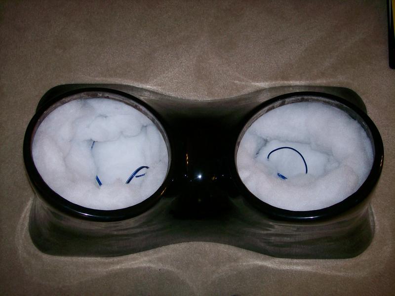

I now have a universal box that holds a pair of twelve inch subs. Gloss black gelcoat finish. I also sell fiberglass mat and related materials wholesale in small quantities my direct email is Azenis29@aol.com. Here is the original stealth box for 1996-2000 civics which holds a single 12 inch sub. Anyone interested in one send me a email. Thanks
