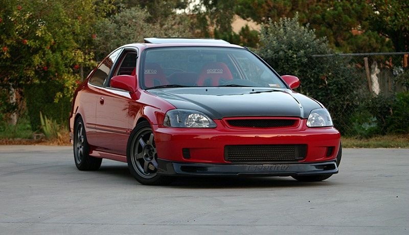

Yeah I lowered it but I don’t know how much, here’s a picture though. I have coilovers so I could rise it if it rubs.

Re: Best Wheel Size For Flush Look
I don't know why the forum ghosted your posts but its fixed and duplicates deleted.
Perfect, coilovers are going to be what you want so you can dial in the exact look you are going for. Only other thing is camber adjustment and I am not familiar with how it works on a 6th gen.
