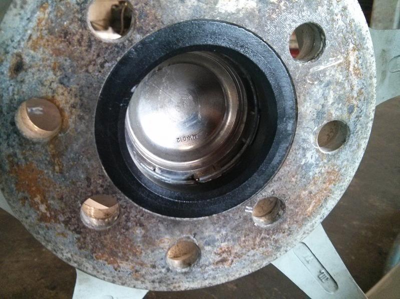

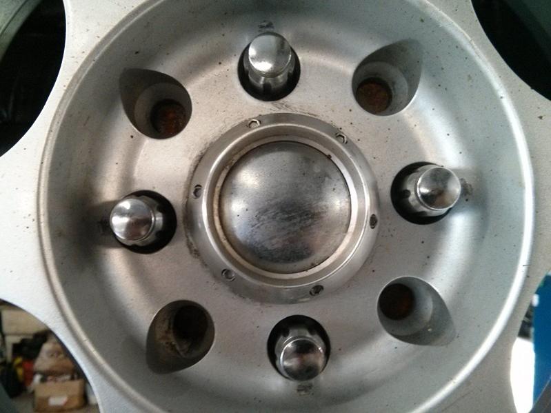

I feel that the tie rod might not solve the issue. Yes the car still vibrates vigorously. I noticed it now after changing my job and my commute has a lot of highway in it.
No i never got centering rings and i think that might be the issue as well. Are hub centering rings common for all wheels or do i need to source specific ones? My take is to fix issues one by one to solve this problem. These are used rims off craigslist for $200.
This is how it sits now. Yes the wheels fits just right and spins right. (no play or looseness what so ever) If you look close, i just got new rotors and brake pads.

Re: Wheels balanced without new weights?
The rings must be fit for both the hole in the wheel and the hub of the car.
Whenever we need them for cars at work, we get sent to the wheel manufacturer to try to get the right size.
My preference is for metal rings, not plastic.
Also, aluminum corrodes and steel rusts, so the rings may not fit good until you get the corrosion out of the hole in the wheel and off the hubs of the car.
The wheels are supposed to be centered by the hubs, not by the lugs.
Balance depends on this.
Jack the front end off the ground and run the engine with the trans in gear, let the wheels spin free. You could probably watch the edges (lips) of the rims as they spin and tell they aren't perfectly centered on the hubs.

Stock Honda lugnuts have a ball seat.
Most other manufacturers use a tapered seat.
You need nuts that are correct for the wheels, most likely a tapered seat.

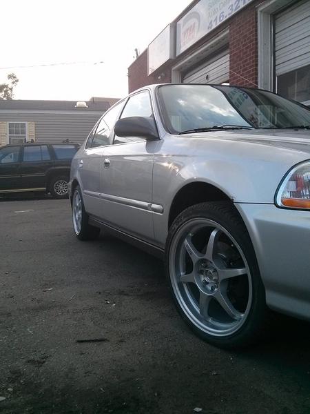

Hey Guys, Mission successful!
Everything done together. Tie rod, hub center rings, tapered lugs. The car is running super smooth even at 100 kmph. Thanks to all of you.

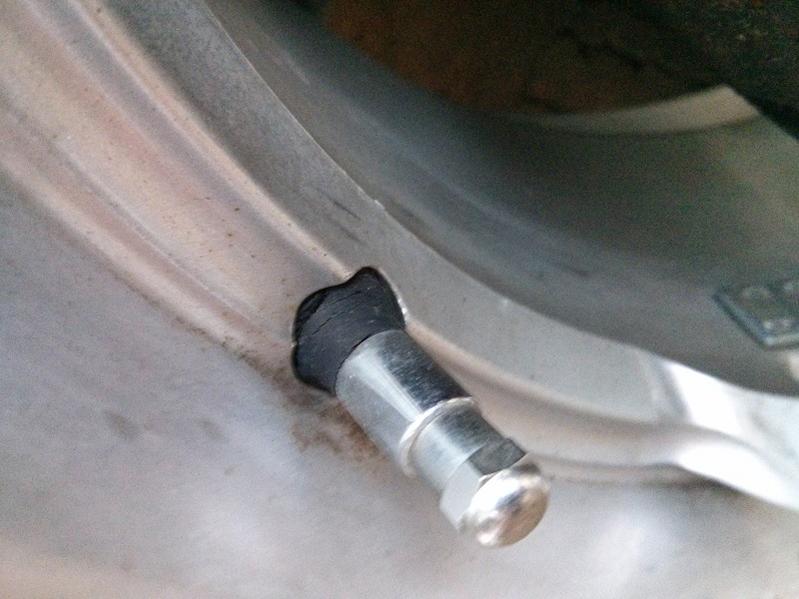

Also, i notice my valves have cracks in them. 3 of them. However they arent leaking. Changing them means re-balancing the wheels
