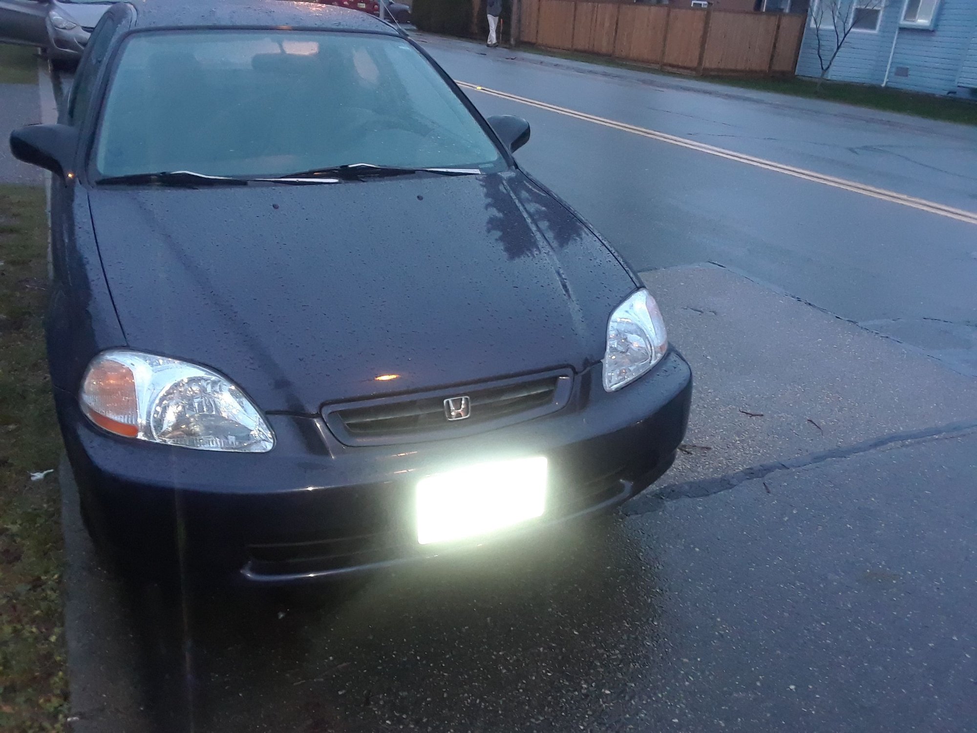

Happy New Year Folks! Recently acquired a 98 Honda Civic DX hatchback with only 145,000 km. Standard transmission and totally stock no mods whatsoever except CRX 14" rims. Car in pretty good shape so I went ahead with a major maintenance including new timing belt and change all fluids. But now sometimes it's very difficult to put in first or reverse when parked or stopped at light. Is an intermittent problem. Could be at a red light turns green and wont go into gear you have to force it. Same going into reverse like to get out of driveway. Can rev motor double clutch whatever clutch pedal to floor you end up forcing it with a clunk. Gearbox oil changed. I parked it for a few days worried maybe the clutch was going and I was ruining the transmission but just started it up and it shifted smoothly into first and reverse when stopped. Did it cold warmed up motor and smoothly engaged reverse. However I know if I drive it around eventually sooner or later it will be hard shifting in first and reverse from a standstill. No problem downshifting from 2nd down to 1st moving slow or fast. This is the only issue when car is moving upshifts and downshifts through all gears and speeds no problem and car runs very nice everything works handles great like new.
Slight shake at 140 kph. Running cheap new snowtires on older CRX 14" rims freshly installed and balanced. Thanks for any help.
