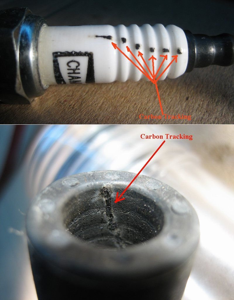

If you have this situation, plugs AND wires MUST be replaced at the same time.
In my experience, plugs and wires should ALWAYS be replaced at the same time. Tried both ways.... never again.
