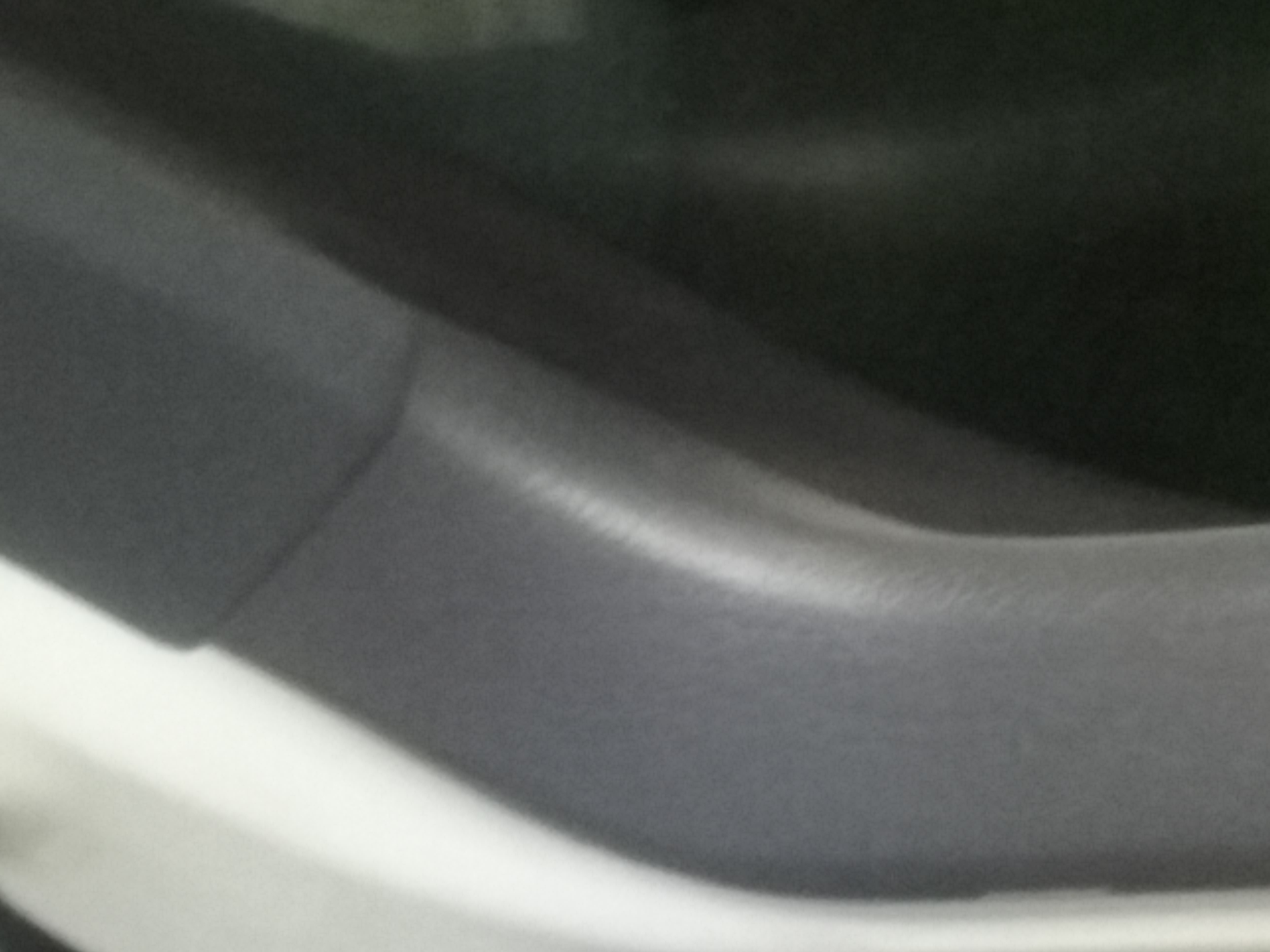

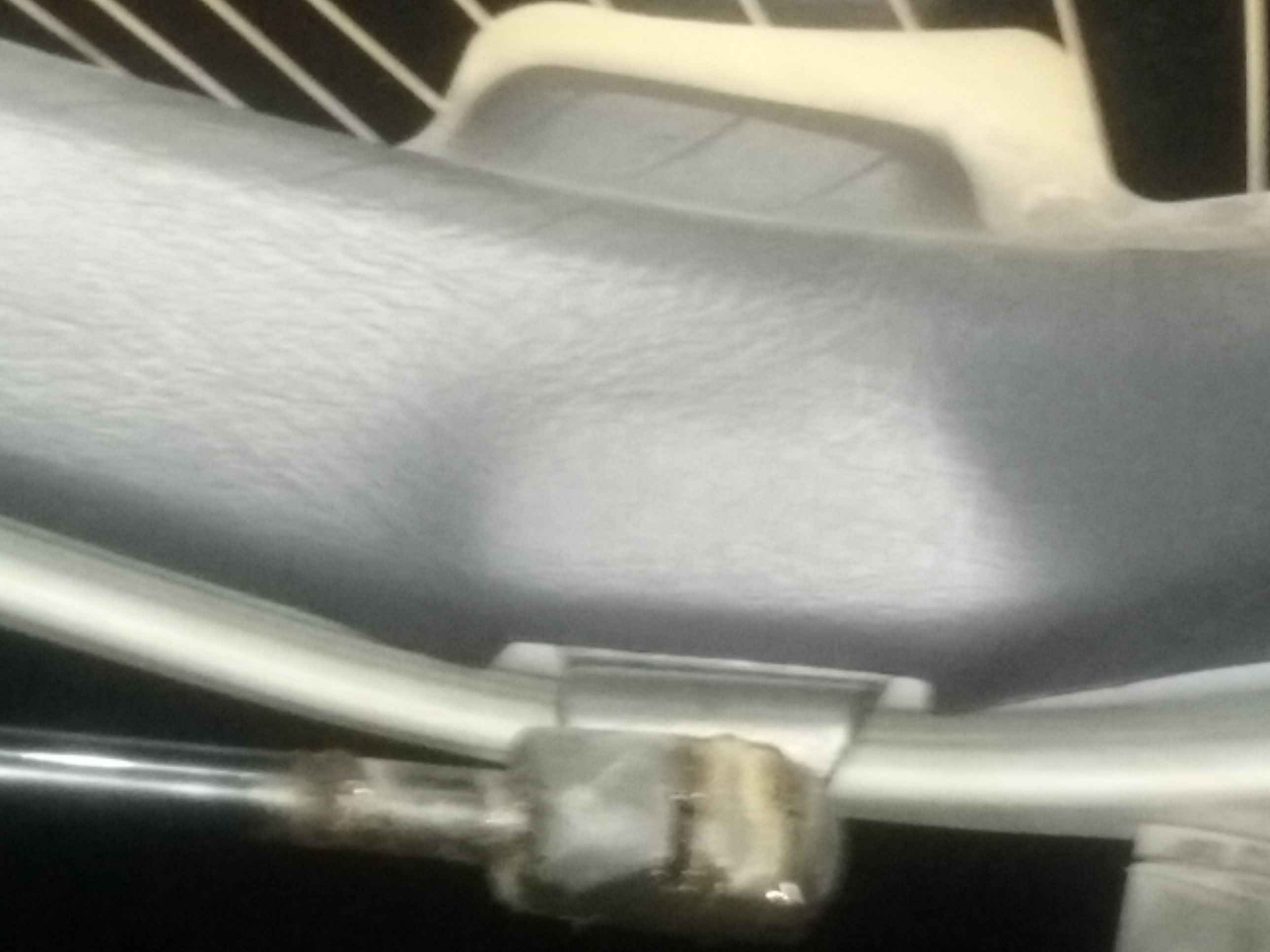

I need to replace the hatchback lift supports for my Civic. I found some @ Rockauto (http://www.monroe.com/en-US/e-catalog/901471/ is for one side).
My question is--the part that is on the left side of the picture (from the monroe.com site), that has holes for screws--it is screwed onto the frame of the car underneath black plastic trim. I took two pics, you can see them here.
My quesition is--does this black plastic trim pop off, or do I need a special tool to take it off--and will it snap back on? The white lines in the second pic are the conductor element in the rear windshield.

Old Aug 8, 2018
Re: Does this pop off?
There's probably a U shaped metal band wrapped around the end that grips the ball on the stud.
Use a pocket screwdriver to lift that U shaped clip out a ways, and the end of the strut should then just come right off the stud.
Make sure the tailgate is supported, don't mash your head.
just pry carefully from different sides, one side will move the most start popping it off from that point
