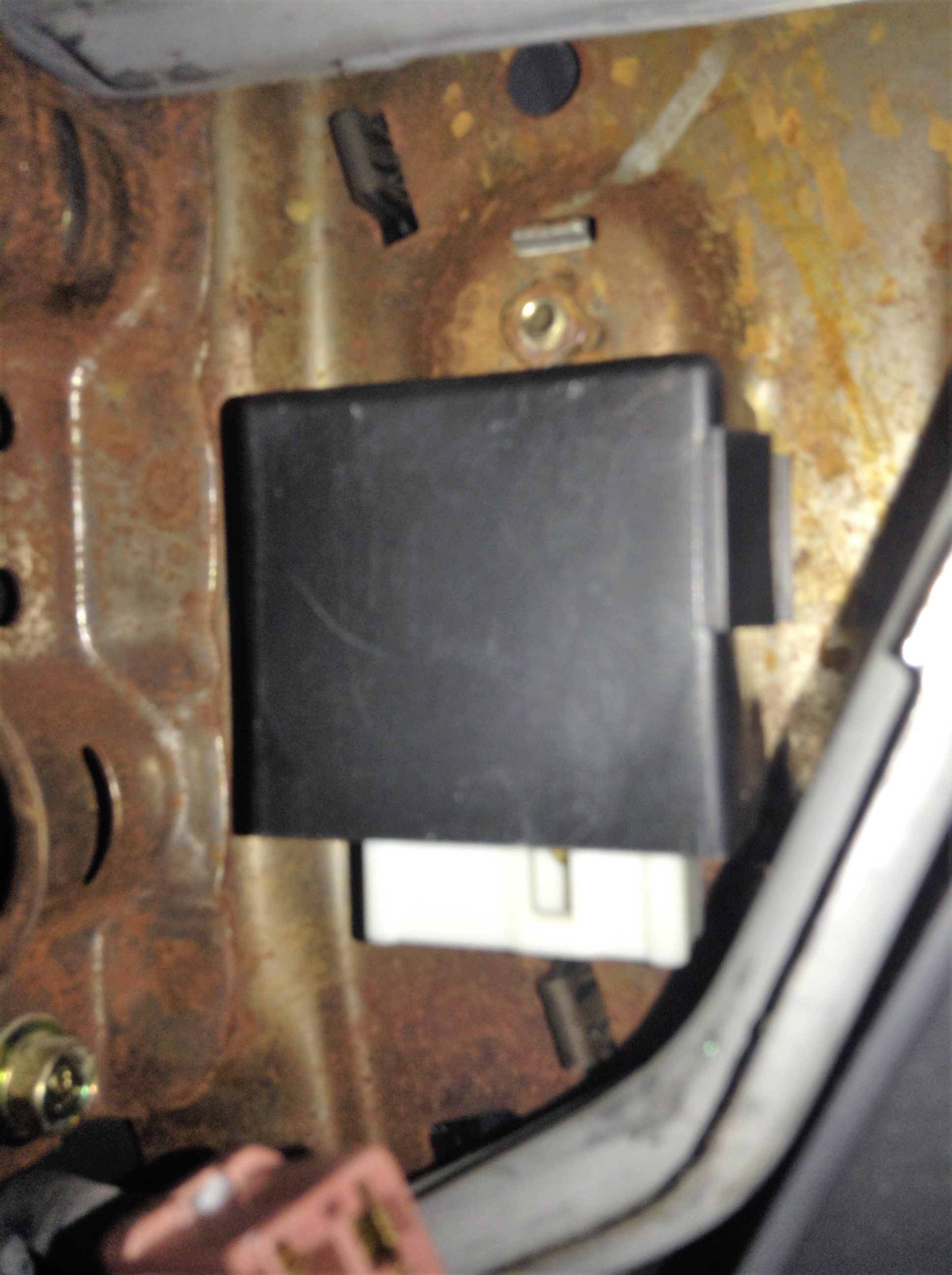

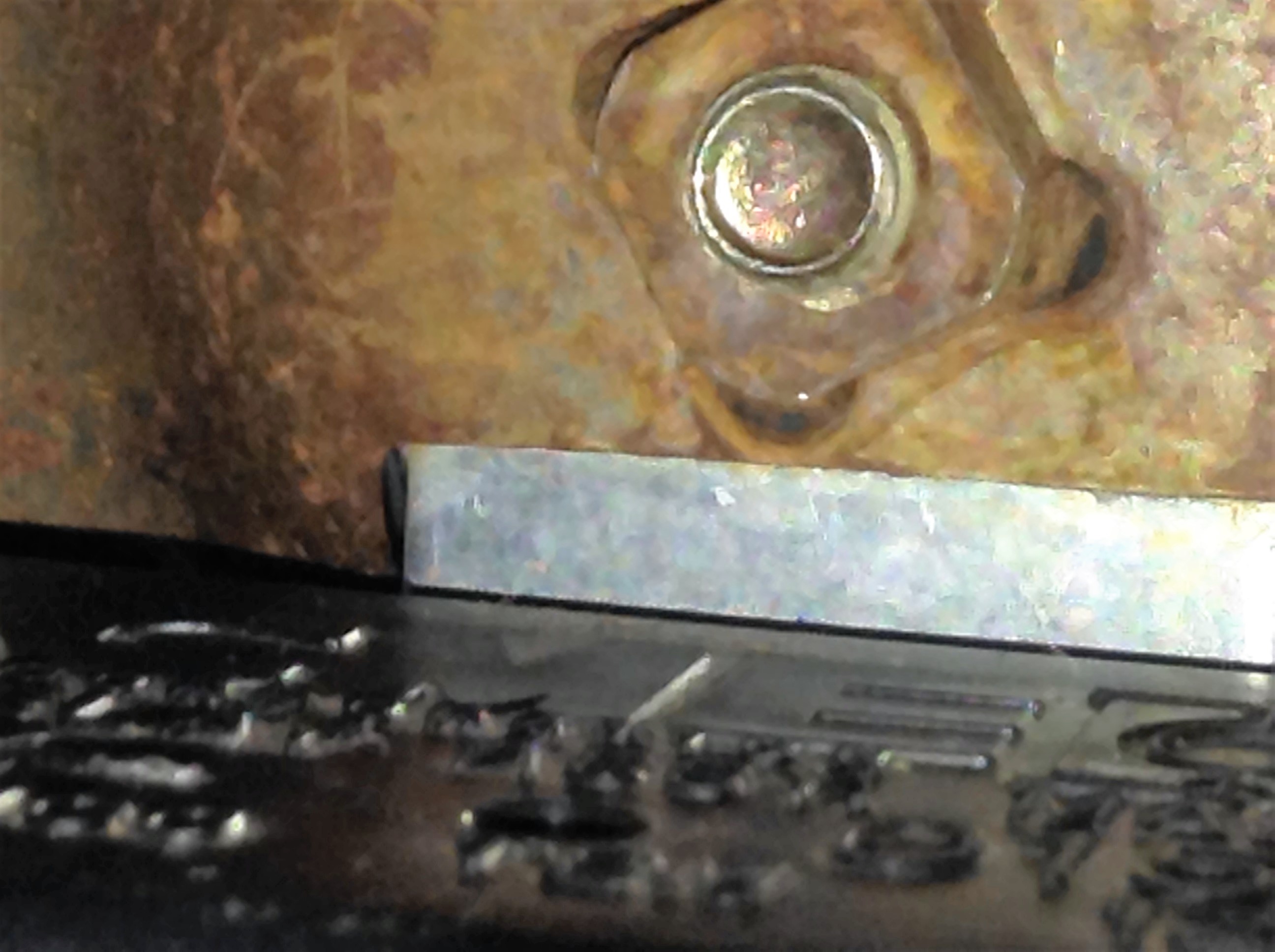

Hoping two pictures of main fuel pump relay attached.
So the right end of instrument panel cover has to be removed. It has some spring tabs that must be depressed.
Have to take out the duct and vent to get to one of them.

Rep Power: 518
Re: timing belt never replaced
Duct/vent does not come out.
Trim will pry out after screws are removed.

OK Hear relay click. Fuel pump runs a few seconds then stops.
Get 4.?? VDC at the connector to fuel pump.
Main relay has two relays. One is 12 V and the other is 4 V.
Guessing the 12 V relay is for the fuel pump.
What about the fuel regulator? Can a vacuum check be made with vacuum pump even though engine does not run?
Do not know about ground wires at thermostat. Can only see a collection of wires near by under distributor cap. There is one wire to head next to ETC sensor. There is a connector it the same area.
