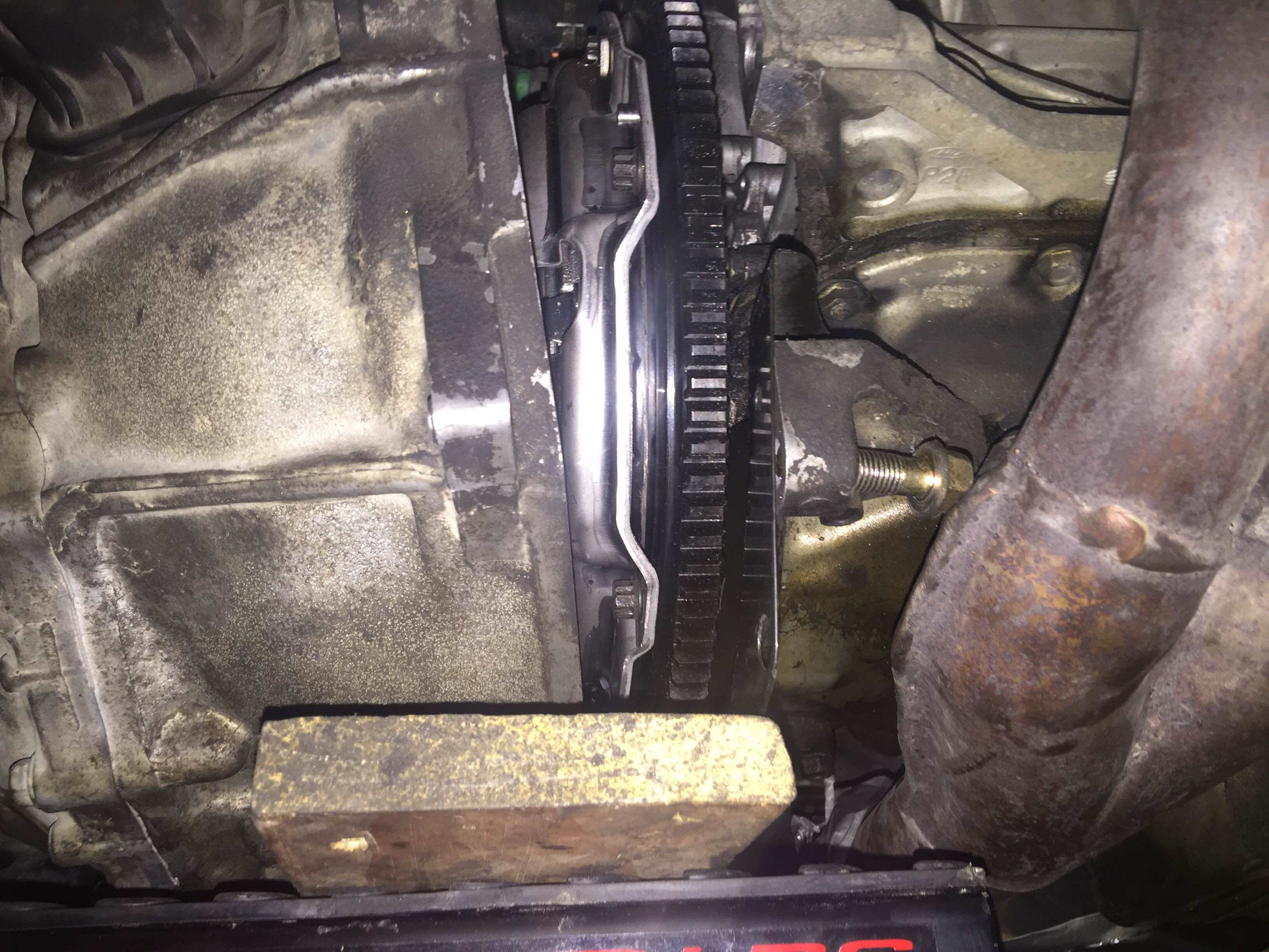

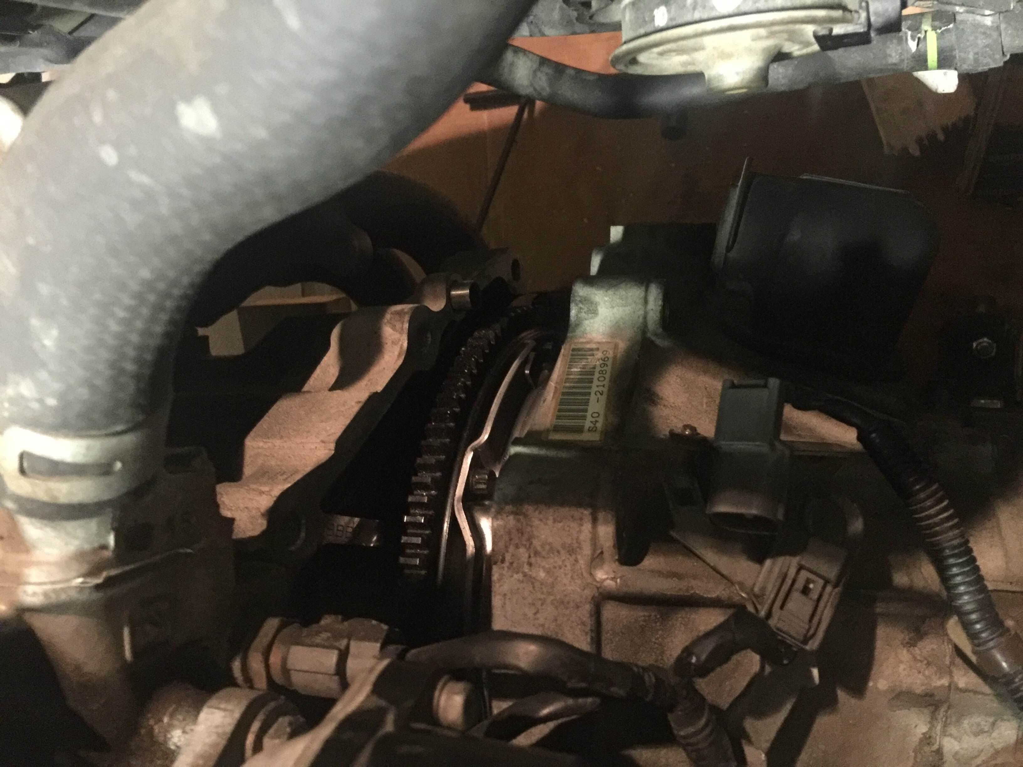

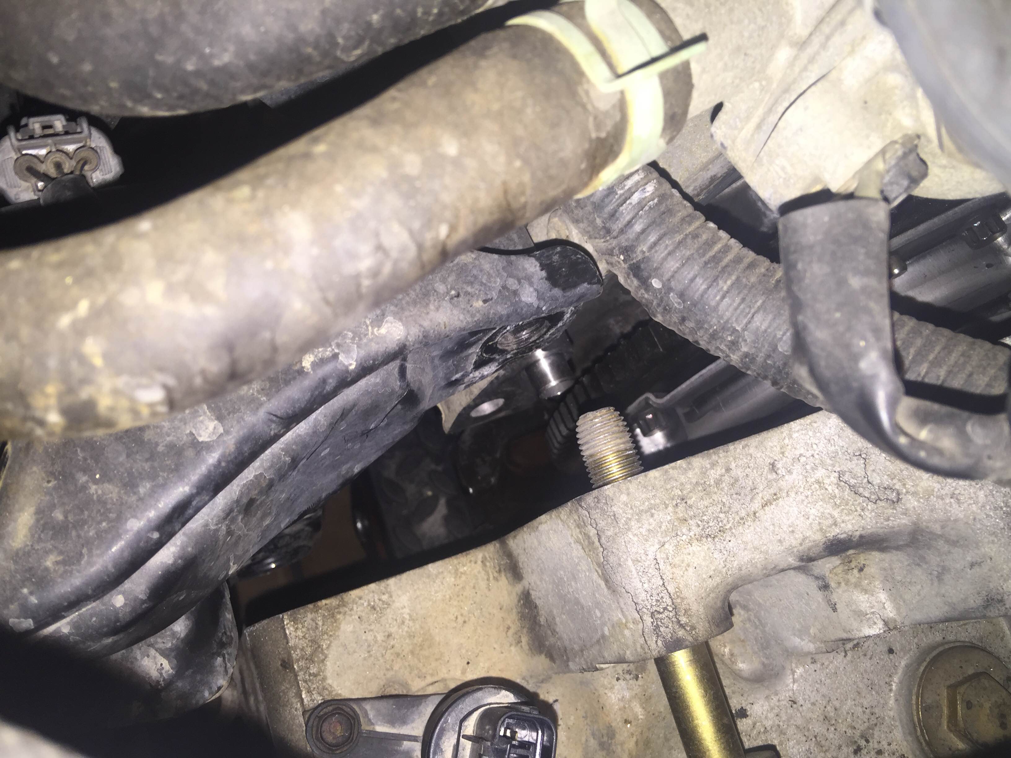

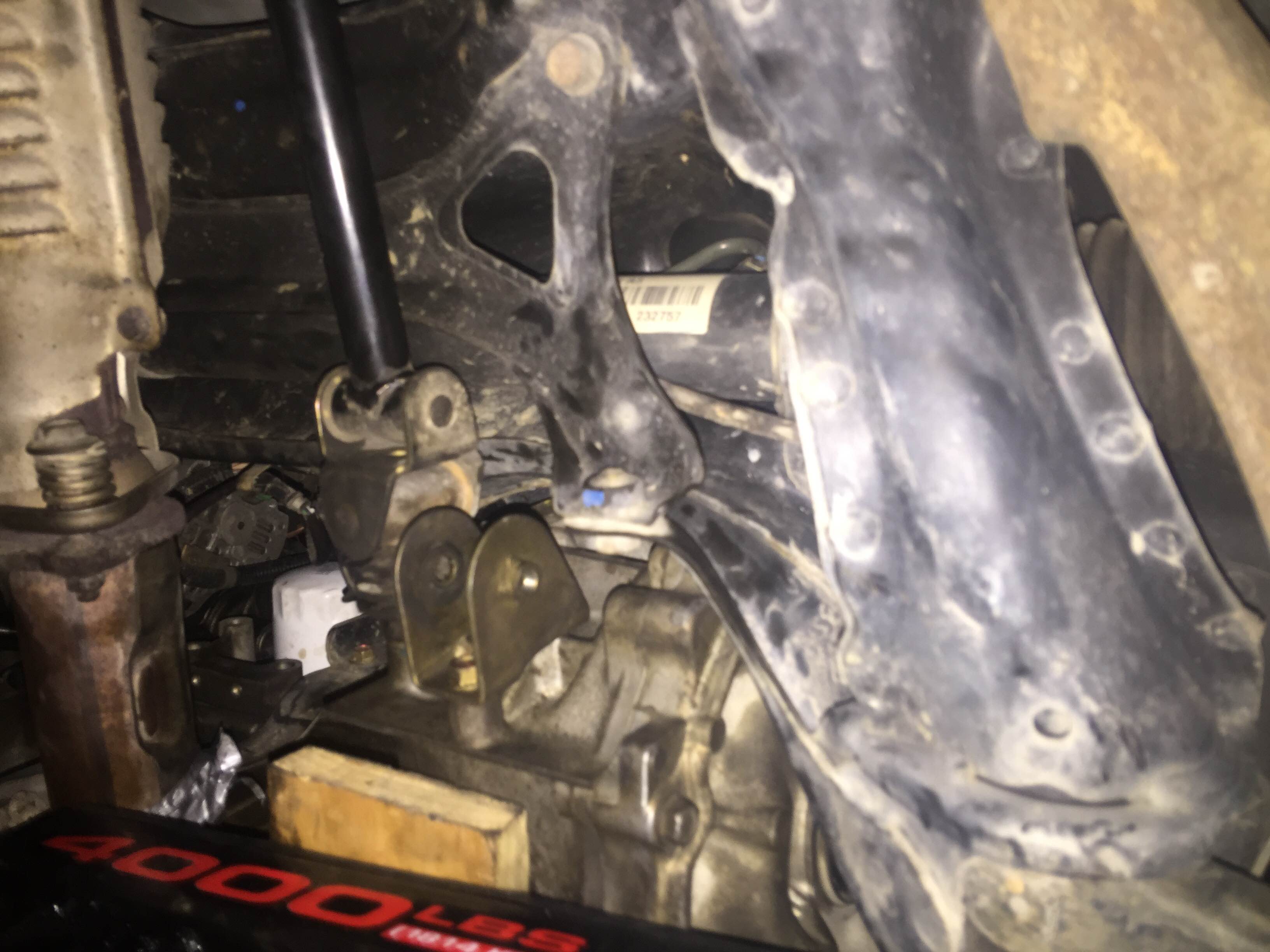

2000 Civic EX, MT. DIY clutch job, one and only daily driver. I followed the above guide to the letter and I am experiencing a nightmare getting the tranny back into the engine.
The alignment tool fits, but nothing I have tried in the past 6-8 hours of trying to fit the tranny back into the engine has worked. Jacking the engine and tranny into alignment get me close, but we just can't get them to mate up to the point where we can close it up.
My brother and I are physically exhausted literally to the point of muscle failure, and we have no idea where to go from here. Any help would be incredibly appreciated!

Did you test fit the disc on the input shaft before you bolted it on?
It can be a PITA to get the input shaft to rotate....try getting someone turn the crank while you jockey the Trans in place.

The alignment tool fits the old clutch disk and the new clutch disk, so I'm assuming the thing fits? I didn't test fit directly though.
Should I be freehand lifting the tranny up and trying to fit it in that way, or am I doing the right thing back jacking it up and trying to fit it with support from below?
How do I turn the crank??
Thanks for answering, we're freaking out over here.

From the front of engine, turn the crank
You sure would expect it to.
Pictures look like you are a long way away from getting it close. You gotta get it straight and somewhat close to the right position before it can slide on.
You gotta get the tip of the input shaft through the center of the disc and then through the pilot bearing, and that isn't easy when you're trying to Hulk it up in place. I'd have it on a jack to hold up the weight but line it up and jockey it around by hand.
Turn the crank and recheck the disc centering by eyeball in several position, the plastic tool doesn't always get it perfect, fine tuning may be necessary.......it's a lot tougher to get the steel shaft in than it is to get a small plastic guide to fit.
19mm socket on the crank pulley bolt.
Take a deep breath, count to 10.....
lather, rinse, repeat
