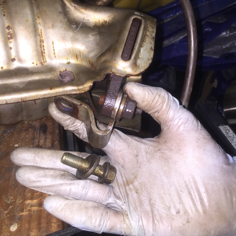

Ok. Also the new aftermarket exhaust manifold's cat's bolt hole isn't threaded so can't transfer this stability? bracket from old cat to new cat. What is the brackets purpose that attaches cat to engine mount, stability of the down pipes? Do I need it? I'm thinking the stability will prevent stress from vibration and motion therefore prevents cracks. Name:  B05lEA1.jpg

You're right, the bracket needs to be in place.... I'd think the weight of the converter hanging off of a constantly vibrating engine, along with the rest of the exhaust movements, can eventually cause it to crack and break if that extra support bracket is missing from the bottom.
Run a tap through the hole and cut new threads in it, or maybe find a bolt size that will slip through the hole and use nut/bolt/washers to secure it.
