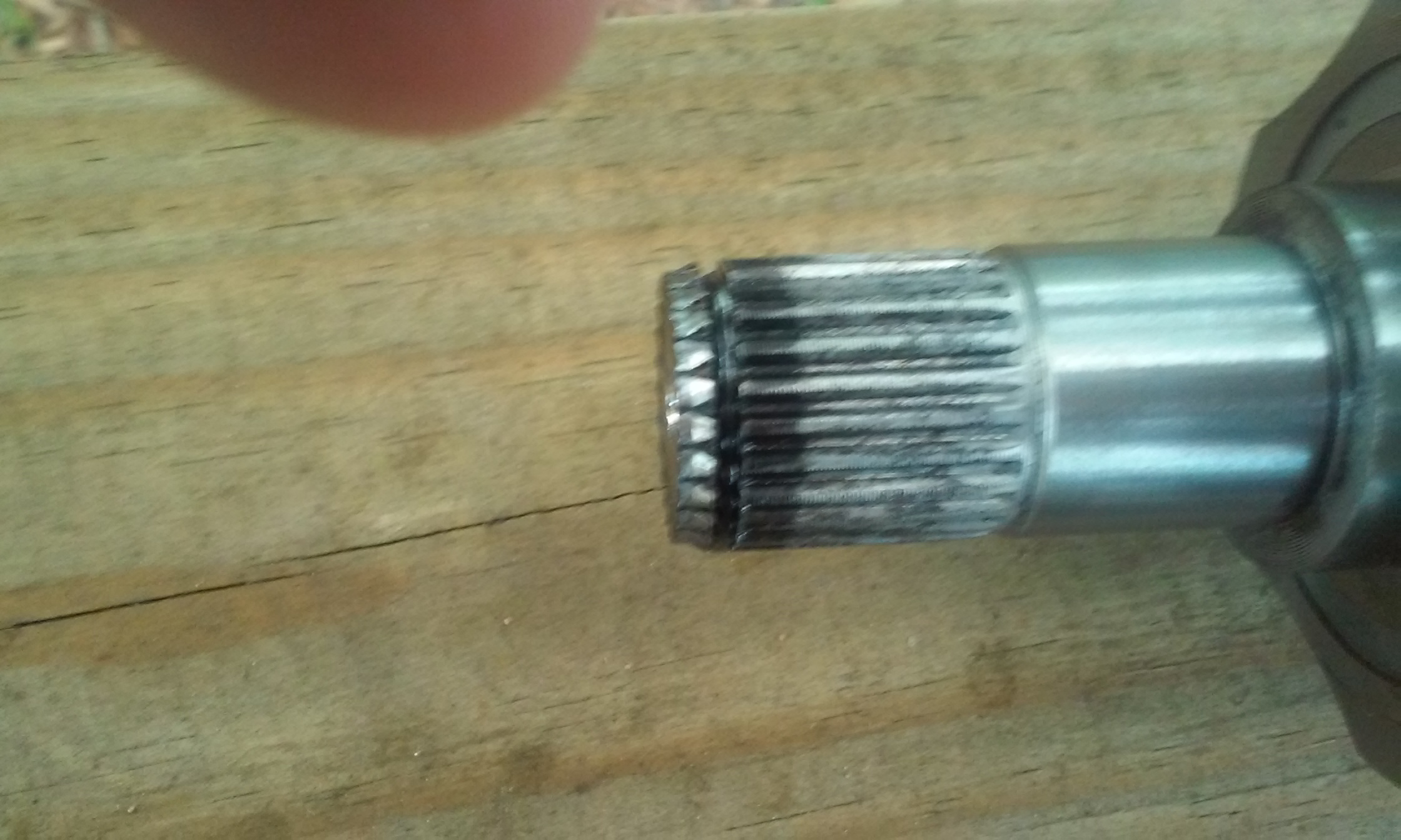

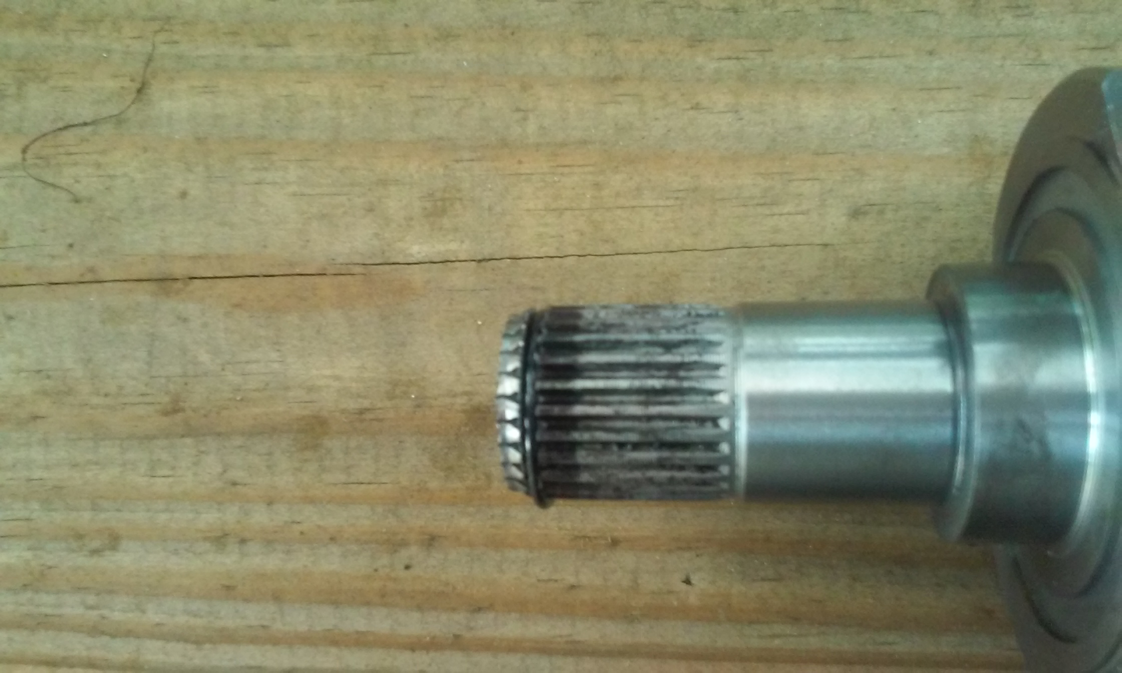

Inner axle slipped out, speedo working,
differential splines look good, viewable shavings next to nil. Clip is/was on, joints working, only noticable damage is the splines are worn at the inner axle tip ( in front of clip).
Going to parts store to replace.
Update!: new part obtained and installed. Have not run engine yet... Should I first do an ATF drain and fill to help remove shavings?
Update: drove it for about 30 minutes.. did not do drain and fill. Amazing how things work properly when installed correctly...lessen learned.
The parts strore was cool..no questions asked. On a positive note there is now less vibration from the motor mounts. Thanks again for all your help Ezone.

Since the axle is steel, any shavings from the damaged splines (hopefully) ought to get stuck on the magnet(s).
Even though it is not real likely to get any of these shavings out of the trans, changing the ATF is always a great idea LOL
