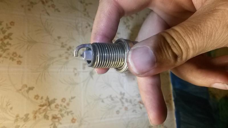

Also pulled a spark plug to check out its condition. Is this a normal looking plug? Looks okay to me but just want to make sure. I changed out the o2 sensors today cause the car has tons of miles on it and they were the original sensors. I figured what the hell since I'm getting the injectors cleaned. Thanks for all the info and help!
I can't see it from here. You might want to post a picture?
What's the brand and part number on the plug?
Ya, normal cheap plugs probably came in it.

I did post a picture. They are NGK plugs (iridium) I put them in back in March 2013. Was just checking on the condition so I posted a picture to make sure it was okay and no problems.
The old o2 sensors had white soot looking stuff on them. I have read that's normal and have read that indicates something. Now those were most likely the original ones and the car has had a leaking head gasket at one point but I got it fixed. It did overheat pretty badly too. So I am thinking the white soot might have to do with that...
Anyway. They are replaced now. I think the spark plugs are okay...again just wanted a second opinion.

Yes, the spark plugs are okay.

For whatever reason, I wasn't able to see any picture on my computer at work. Sorry.
The plug looks fine IMO.
The white is just ash, it's normal too.
