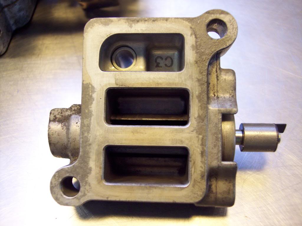

Ok so the issue is at least isolated to the IAC valve area.....I"m thinking it may be partially stuck and can't close its passage off completely.
Try tapping on the IAC valve from underneath with something small and solid? (Like a small hammer, but not hard enough to bend the aluminum) If the idle speed drops at all when you do that, it's sticking.
http://www.odyclub.com/forums/9-problems-concerns/27649-diy-cleaning-iac-valve-idle-surge-no-more.html
The small blade between the two air chambers must be completely free to pivot from fully open to fully closed. It only takes a little bit of crap to keep it from closing all the way.
I've had a little success just filling the passage with carb and throttle cleaner and letting it soak a while, but it's not reliable enough to actually call it a guaranteeable fix at work.
