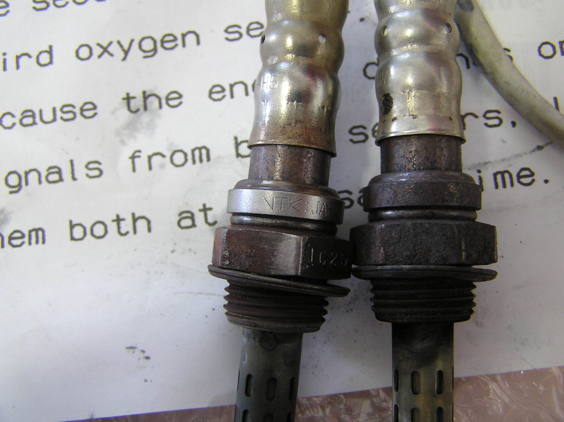

About the O2 sensor, is it actually written somewhere on the body of the sensor?
If it's original, then I expect it to be stamped somewhere. Here's an example pic from a completely unrelated job:

Many thanks for ezone, it doesn't get any clearer than that!

Update re: fuel mileage....
New NTK O2 sensor put in in January. Driveability issue disappeared.
Fuel mileage now observed to be better, due to different driving pattern. Earlier in the year, the car stayed put most of the time and was essentially only being driven on the weekends, and for short trip local driving. When I calculated fuel economy it was always really bad. On some short trips, I estimate half of the time was spent idling at a red light.
Now I am in a different situation and drive about 100 km/day (60 miles) on the highway. Fuel consumption is now 7.2 L/100 km (32.6 mpg). This is with speeds anywhere from 100-120 km/h (62 to 75 mph). This is good news, so the engine is still doing pretty good for its age and mileage. (just turned 274,000 km) (about 170,000 miles)

Another update on fuel mileage...
Got 6.6 L/100 km on one tank (35.6 mpg)
6.0 L/100 km on another (39.2 mpg)
Leads me to believe I don't have any major issues with the engine. I believe I will hang on to this car for a few more years!
