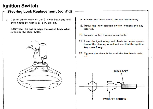

What you would need to do is figure out how to remove the breakaway (shear) bolts (#3) that Honda uses to secure the column lock and clamp (#5) together on the column.
There are several methods: Drill them out, use a center punch and hammer to turn them out, saw or dremel a slot so you can use a screwdriver..... Whatever you have to work with and how much room you have to work in determines the method.
Found this for a 94 (wrong year car, but similar)
New breakaway/shear bolts are fairly cheap.
HTH
