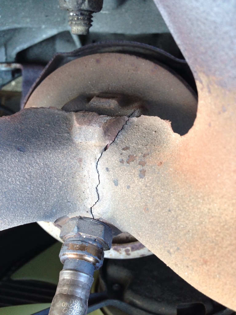

i was gonna replace the sensor but found this..

Re: cel p0135 on 96 LX
Erm, that's real common.
A cracked manifold is a separate problem.
Replacement manifold alone will not fix the P0135.
It (most likely) still needs a new front O2 sensor to fix the code.
i didnt know it was a common problem on civics..
didnt replace the O2 sensor.. much better if i replace them together..
problem is i cant buy a new aftermarket manifold/cat on EBAY. no legal in CA.
did a research here..
maybe this is a temp fix?
What have you got to lose, maybe $10 if it doesn't work?
I've never tried it, but go for it.
I've heard others talk about brazing the cracks closed too.
