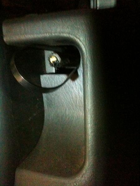

my handle inside broke off too. I couldnt justify going to a junkyard and working and or paying to buy another 15 year old plastic part thats just as likely to break as the one that i had...
I'm a cheap bastard and no one will ever see this, so i went CHEAP!
couple zipties... did this a couple years ago... i only use the black ones, but they come in all colors... i just caution you, the black ones are the only ones that i know are uv(sunlight) safe, UMMV
just tightly ziptie one large looped ziptie to the shaft with another... plenty strong...

i carried pliers and did it that way too till i figured out the ziptie thing...
