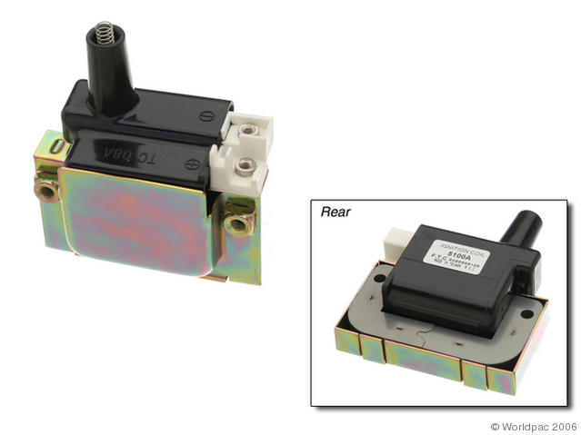

Well Mine looks like this,
I replaced that little spring from the igniter to the cap, plugs and wires. Hope this helps. Yeah, sorry I didn't know what terminals you were talking about. The ones from the modulator going to the coil, I made sure they were nice and snug.
Old Jun 7, 2012
Re: 99' Civic Died While Driving, Wont Start.
Your pic is the ignition coil.
Mine was of the ignition control module (commonly called igniter).
I know I mentioned that little spring in an earlier post.......So, did it help?
