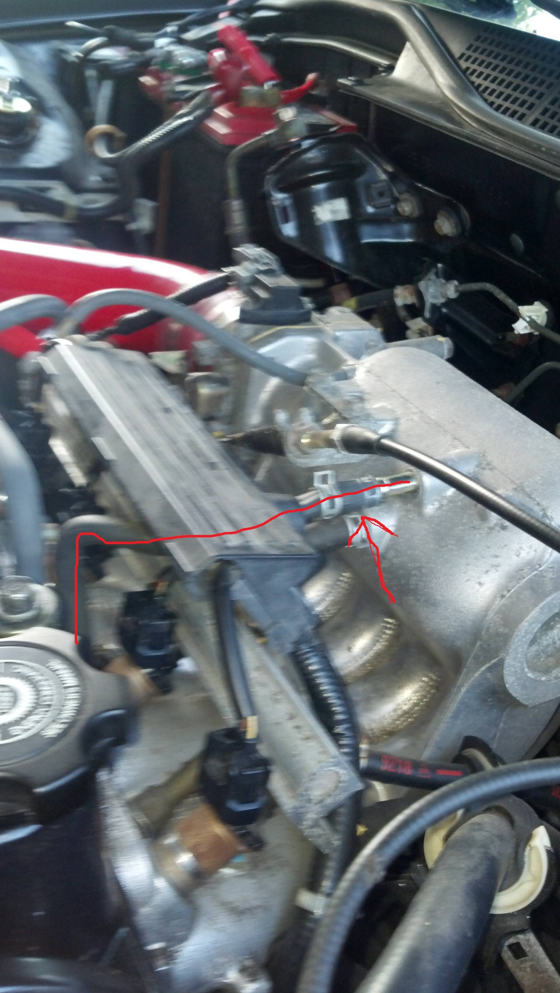

what's this hose?
Old Apr 3, 2012
pwnsauce's Avatar
Joined: Jun 2011
Posts: 710
From: Dayton, Ohio
Rep Power: 189
pwnsauce is a jewel in the roughpwnsauce is a jewel in the roughpwnsauce is a jewel in the roughpwnsauce is a jewel in the rough
what's this hose?
what does this hose go to? my car wouldnt start when i was suposed to leave for work...after close inspection i found this hose colapsed and stuck shut. would this even prevent the car from starting?
i need to know asap. rep is up for grabs lol
Old Apr 3, 2012
Re: what's this hose?
http://www.hondaautomotiveparts.com/...HAMBER+%282%29
Looks like the hose (#4) for the PCV valve.
I don't think this alone will keep it from running, but you could plug or pinch off the hose near the nipple on the manifold to stop vacuum leakage for a test.
Then you will find it still won't run, so you better start with basics like spark, fuel, and compression checks.
HTH

hmm well when i take the hose off the rpms bounce all over the place. 1k-3.5k. when i plug the nipple the rpms drop to like 150 and it almost stalls.
im not sure what changed but i pulled the valve cover off to take a peak and pulled the cam gear cover off. then put it back together and it started, rough but it started. now seems to start fine. i think its got something to do with fuel. i can smell gas pretty bad
anyways compression test and search for vacuum leaks tomorrow

The PCV valve is a CONTROLLED VACUUM LEAK. The leakage is calibrated, so the system must be intact for it to work right.
Hose removed is a huge leak, that's the normal reaction.....
and blocked off will not be enough of a leak. Again, that's probably the normal reaction.
If it starts and runs NOW, you won't find anything wrong. If it runs RIGHT, I wouldn't bother doing anything else to it until you can prove something is wrong. Then test stuff.
I bet you just flooded it.....
Operator error?
Got a scenario that happened right before it wouldn't start?
Did you move the car 10 feet and shut it off?
HTH
