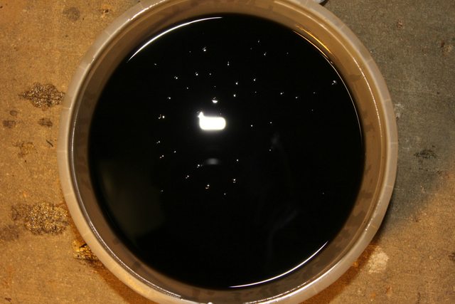

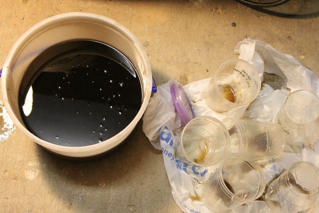

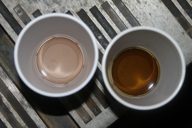

I changed my D16Y7's manual transmission's fluid for the first time doing it myself. Have you ever seen old transmission oil this color? It looked like really old engine oil to me but don't know a way of finding out what the previous owner or serviceman had put in there. The new fluid I put in was Honda's MTF. Since the old oil was so bad, should I change its fluid again after I drive a week or so? How would you describe the old oil by the pictures?

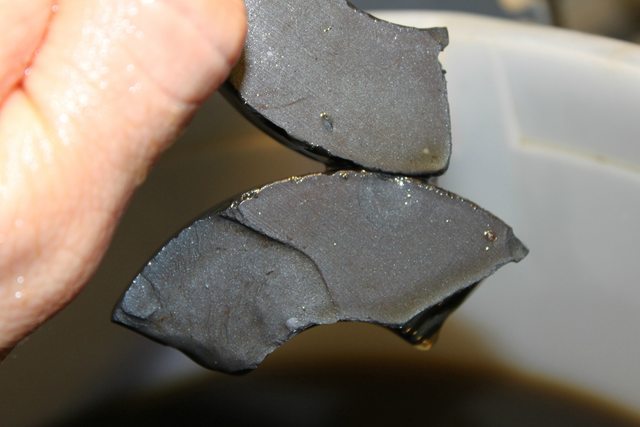

I dropped some magnets in the old oil to attract metal fragments and found some. However, I don't know what's a normal find and not normal since this was my first time. Found little fragments here and there.

Metal fragments aren't a good sign. Could be parts of the gears or synchros. When was the last time it was changed? If it had been in there forever, that color doesn't seem like anything out of the ordinary to me. I changed my MTF a few weeks after I got my car and the fluid looked just like the stuff that came out. One of the other guys should be able to add to this. I personally would run through the new fluid for a while. How was the shifting prior to changing the fluid?

Regular engine oil used to be called for by Honda, ordinary 10w30 or 10w40. Not sure when that stopped and they went to their MTF (which still looks surprisingly like engine oil).
So it could easily be regular engine oil. It would probably take a zillion miles to turn it that dark though.

To help with that, the teeth that have to engage have points ground into the sides of the teeth (when new) so there isn't flat edges of the teeth trying to butt together, but every time someone grinds the gear a little bit of those points gets ground off. (This COULD be the source of magnetic material that was picked up on the magnet.)
