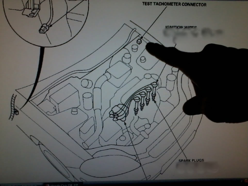

OK, now disconnect ECM/PCM connector A(It's the only 32 pin connector) and check continuity(Ohms) of the yellow/green wire from dist to ECM/PCM. There should be continuity.
Check continuity from the yellow/green wire to body ground. There should be no continuity.
Check for continuity from the white/blue wire(dist) to the test tachometer connector:
Check for continuity from the white/blue wire to body ground. There should be no continuity.
If all tests are normal replace the ICM (Ignition Control Module). It's number 7 but, you would have to buy the whole housing( number 4): http://www.hondapartscheap.com/south...t=0&quantity=0 Or this place has 'em as cheap as $36: http://www.rockauto.com/
