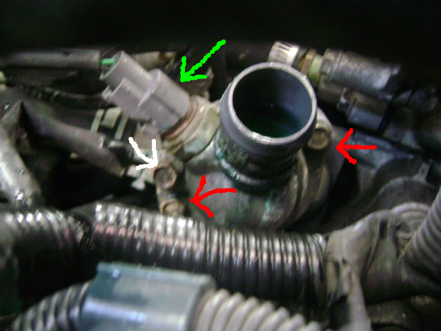

It's the solenoid the green arrow is pointing to on the thermostat housing, cant seem to remove it to remove the ect switch, also im planning to remove the ect switch with a wrench, its just like removing a screw right? No need to disconnect the battery or drain coolant right?

You don't have to drain the coolant, just pull the hose off the thermostat housing and lay it over to the side pointing up so you don't lose anymore coolant than you have to. Unscrew the thermostat housing bolts (red arrows). Pay attention to the direction the thermostat is pointing (it should only go in one way). That solenoid/switch (green arrow) should just unscrew from the housing with a wrench. Put it all back together, top off and burp the cooling system.

you should be able to unplug the grey connector with green arrow (just squeeze the clip on one side to release it and pull up), then use a deep socket to remove the sensor. the air introduced will almost be like nothing but it doesnt hurt to bleed the air out anyway. i dont think its needed for such a small procedure.

edit: I don't know what I was thinking. That solenoid you just squeeze and pull, maybe twist a little.
