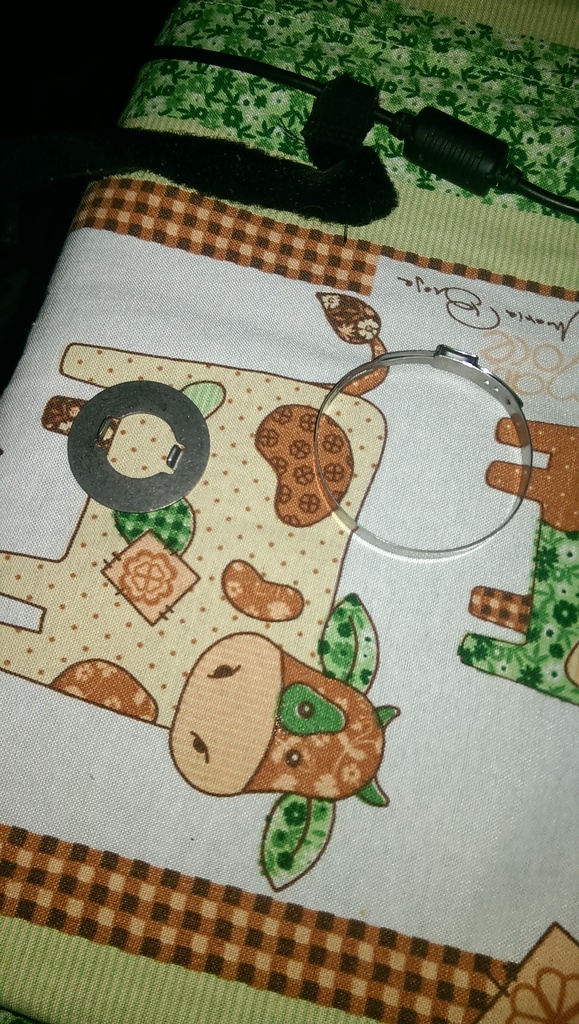

- 53536-SDA-A02 - Washer, tie rod lock (Aprox $1)

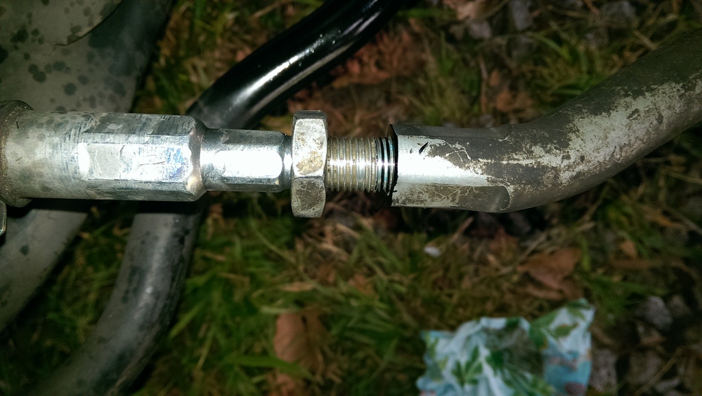

1- Loosen passenger side wheel nuts and raise vehicle from this side.
2- Place a jack stand for extra safety and remove the passenger side wheel
3- Apply some WD40 in the alignment nut of the inner tie rod and after a couple of minutes loosen the adjusting nut
4- I recommend cleaning and painting the threads here to maintain Alignment.
5- Start loosening the tierod in a CLOCKWISE orientation COUNTING THE TURNS for extra assurance of maintaining the wheel alignment. Remove boot.
6- Turn your steering wheel all the way to the left. Hit the Tie Rod Locks or try twisting these so you can loosen the rod. I used an adjustable wrench but I know there are special tools for this.
7- Once the Tie rod is out, turn your steering wheel all the way to the right.

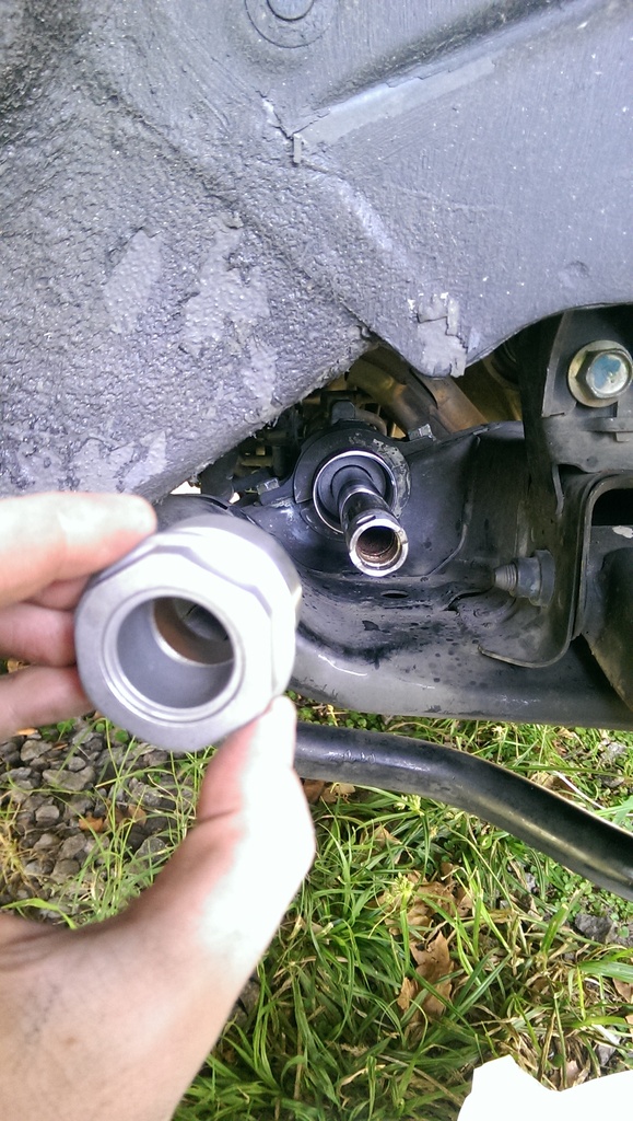

8- Locate a pre done hole and drill a 3mm hole on it. You can refer to the step #11 of this guide...
Steering Gearbox Overhaul - Power Steering I think this is needed to just allow metal shaving out while loosening the End Cylinder.
9- Loosen the End Cylinder using a 41mm Socket
10- Clean rack, threads really well. Put the new End Cylinder in and tighten it to 93 N·m (9.5 kgf·m, 69 lbf·ft).
11- Assembly is reverse of removal, Please use NEW tie rod lock washer (53449-S84-A01) and new Boot band (53536-SDA-A02). Tighten inner tie rod to 93 N·m (9.5 kgf·m, 69 lbf·ft)
Following this steps I was able to remove this annoying noise. I hear no mor knocks on the passenger side wheel now. =)
