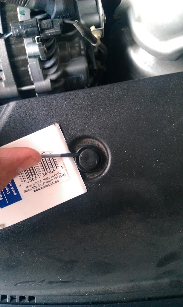

Now pull out 4 of those pesky fasteners from the radiator cover thing.

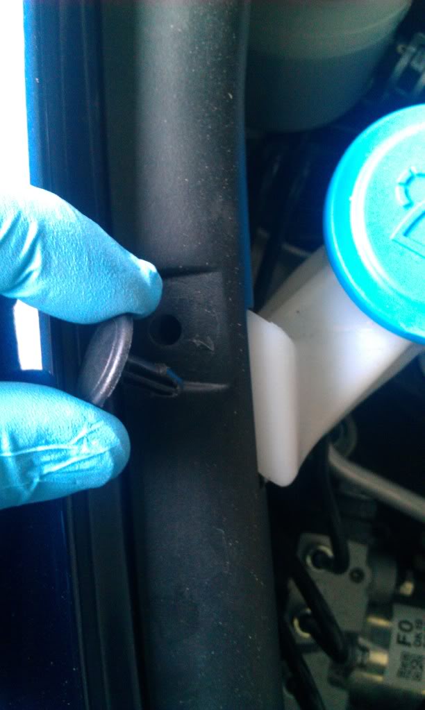

I pulled an additional fastener that holds the washer fluid for ease, but wasn't necessary.

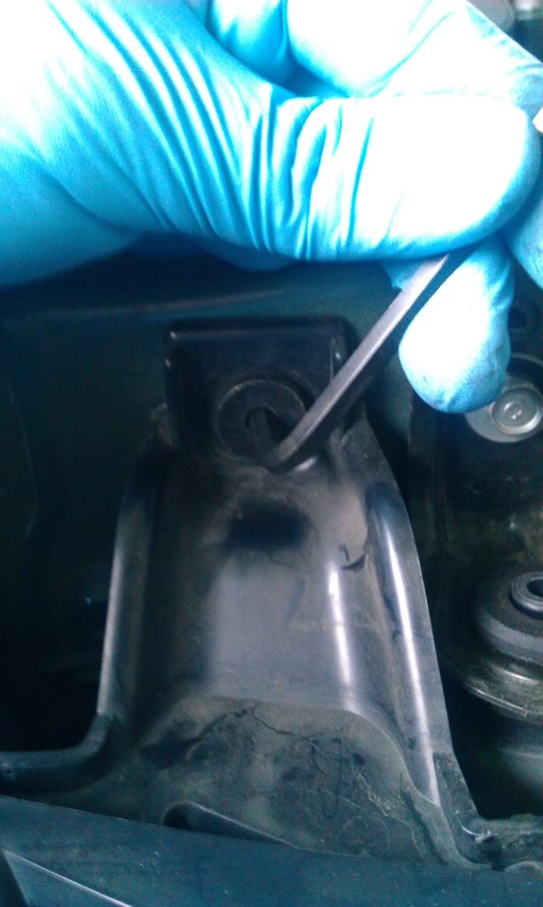

Now you need to remove two Allen screws out with a 3/16 that are under the cover you just pulled out.

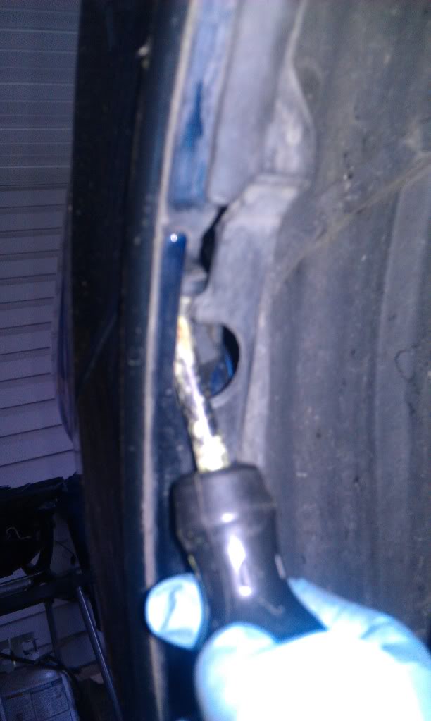

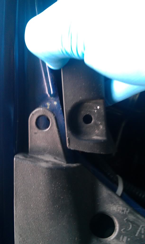

Then a Philips head screws from the inner fender on the left and right side. Two total.

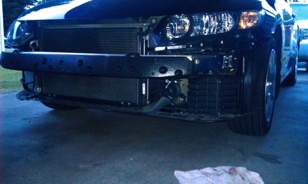

Now start on either side of the car and start pulling the bumper away from the car. If you haven't removed all the fastners, and screws your not going to win and risk scratching your bumper when the thing gets hung up. I was moderately forceful, and didn't break anything, loose anything, scratch, chip, or even cuss. I worked from the left to right using my leg as a brace for the bumper.
