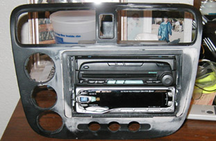

Mine is ISO mounted. The PPI PAR-245 and FRX-322 aren't mounted yet, I think I'm going to take the faces off and mold them right into the bezel. Yes I made my bezel and painted it as well. Not too tough. If you'll be at the Phoenix meet this weekend I'll show you. Here's a pic of how it started. I just bought the adapter kit that need to install an aftermarket deck and hacket it up. After supergluing it in place I bondoed the begesus out of it. Sanded and painted. If you think this is too much of a project, don't fiberglass the trunk. I'm in the early stages of 2 PPI PRO flat pistons behind the taillights and one PPI DCX 12 in the center with 2 PPI PCX amps on the sides. Dallis

ill be at the meet and bring my piece. i dusted it with a coat of black the other nite...it needs work.
im not scared of glass...on my dash i have used abs plastic, hot stuff glue, marglass, bondo, duratec primer (cracked), aluminum (didnt like where my deck was at with stock iso mounts so made new points) and rivits. im not scared of projects...lol ill soon be finding a home for two 15's, 3 amps and 6 crossovers in my trunk.

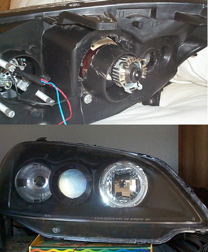

The stereo took a backseat to another project I had to finish (last night as a matter of fact.) I retroed Audi S4 HID's into my projectors. If anyone has seen these projectors, they not only suck stock but the halo (angel eye) is over the low beams so you can never see it lit up with your lights on. So I pulled it and transplanted it over the high beams (see photo.) Then I pulled the LED's and replaced them with 10,000McD bright white. So the whole thing has an elegant look.
