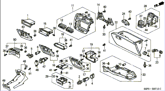

parts # 48 & 49 are 2003 specific, as opposed to # 43 from the 2002's

# 3 is the ring to be removed, # 4 is removed to reveal the screws to get off the trim piece # 48 from the first diagram I attached
Hope this helps.
