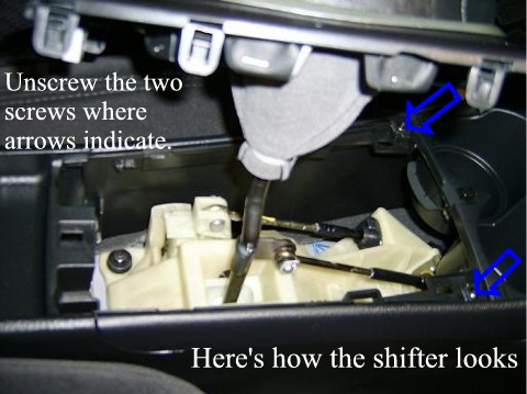

Sorry to bring the topic back but i have pictures for 2004 civic head unit removal
I was confused with the vocab and terms the O.G. here used so here are some pictures.

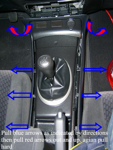

a
a

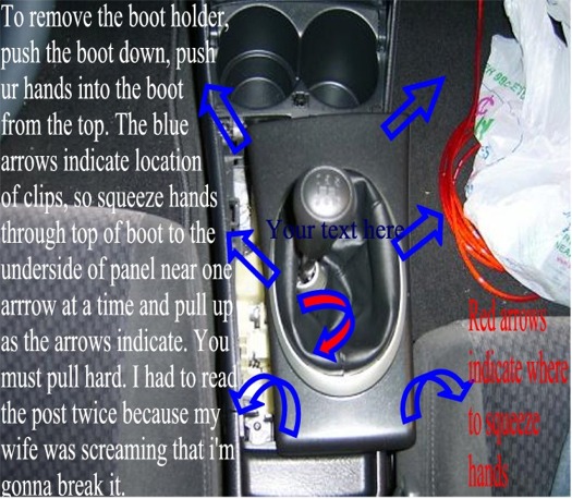

a
From here they are the same as the other civics
