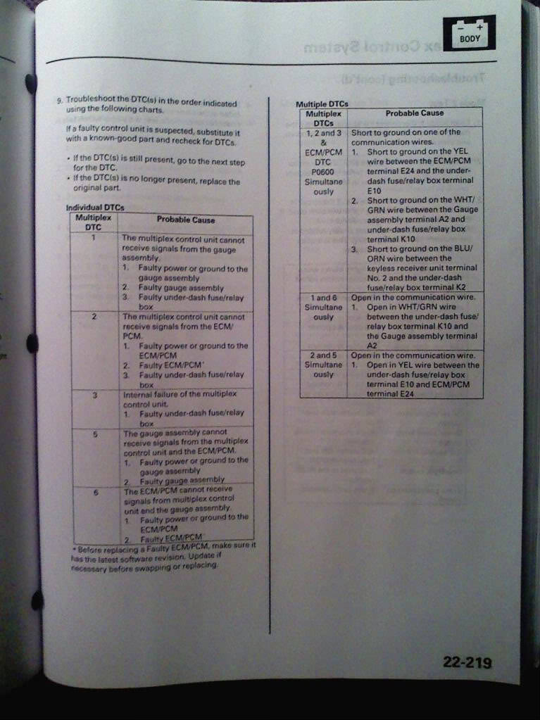

DTC Code 2 and DTC Code 5. The dome light flashed twice and then five times.
The troubleshoot says that if 2 and 5 are simultaneous that there is an "open in communication wire" Open YEL wire in the under fuse dash/relay box E10/E24.
So what exactly does that mean? Is it related to the Battery light/car intermediately dying?
Should I change the MCU Like the other person that said it fixed the problem? Why is the MCU randomly shutting off the car/restarting it?

Old Jul 7, 2018
Re: 2004 Civic Battery light on
Consider this: If the PCM lost its ability to communicate with the micu, would the micu set that code?
I'm not sure the micu has that ability.
Old Jul 8, 2018
JuniorDavis's Avatar
Joined: Jun 2018
Posts: 20
JuniorDavis is an unknown quantity at this point
The only thing is the car drives normal aside from the battery light and the intermediate shutting off for a split second. When it shuts off it's a hard shutoff and the main relay clicks like it's priming the fuel pump.
I suppose there really is no way to test the MCU and the ECM? Can I do anything with the yellow wire at E10/E25 to test it?
I think my approach now will be what I saw on this website about changing everything out one by one starting with the dash, MCU, ECM. The question is would the gauge assembly cause this type of issue? DTC 5?
Does the ECM go through the gauge assembly first and then into the MCU? I don't understand what it's recommending with that yellow wire.
Old Jul 8, 2018
Simple continuity test, making sure that wire in question is a complete circuit between the two connectors mentioned, and a terminal tension test.
I'll also suggest you search this forum using the term "loose alternator bolts", and you can read about countless ruined PCMs
