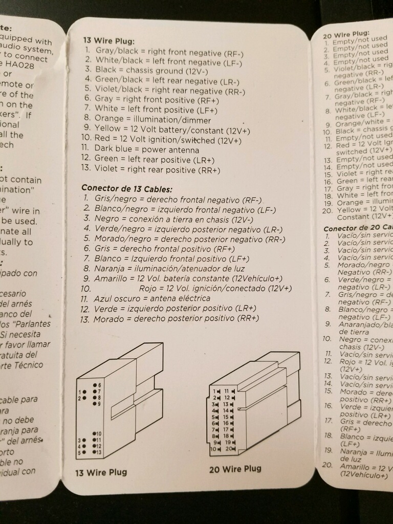

Here are the instructions i followed
ID:	111886   Click image for larger version
Old Dec 22, 2017
Rep Power: 518
Re: 2005 civic lx "small lights" fuse blown
The wires for radio illumination should not be connected! (#8 orange?), 2nd pic
ON the 20 wire plug, #9 and #19 (orange/white and orange) would be the illumination pair (next page of the instructions)
Most aftermarket radios aren't compatible with the way the car controls the dash lights and will burn out the dimmer control which is in the gauge cluster circuit board.
There have been a couple threads with pics of the damage this did to the gauge cluster circuit board, it's not pretty.

orange wires was a good lead. The orange wire and black/orange wire were touching behind the dash and shorting out. Since they were used for the other plug I thought nothing of them. There was a hidden wire which connected them to my side of harness.. Taped separated and good to go! Thanks guys!
