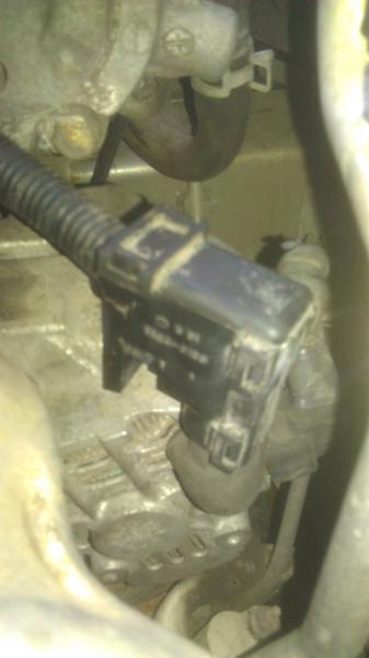

I didnt have a battery indicator light to indicate issue with alternator. When I was having the issue, before starting car battery was 12.59v . 14.7V with car stated. 14.5V with car stated at the time I didnt have the issue.
I took out the power steering pump and checked the alternator bolts. upper and lower bolts were tight, and so was the tensioning wing nut. There was tension on the belt as well.
I couldnt figure out how to remove the black little enclosure going to the alternator. I was able to slightly pull up the rubber boot on the upper wire going to the alternator and it seemed tight and the lower connector wire seemed snug in there as well. Any electrical connections I should check or readings I should take such as ones going to ECU?
I'm going to put the power steering pump back in and do some more testing. From what I recall, When the issue is present, the imobilizer light was flashing (more than the initial 2 seconds) with the key just in the ON position. When this happens, no communication through obdII either.

Old Nov 20, 2014
Re: ECU issue??
From what I've seen, the light doesn't come on while it's trashing the PCM.
Hell, half the time it doesn't even come on when the alternator goes bad.
From what I've seen, most of what you can see in and on the car is not affected.
The problem apparently lies between the alternator which lost its ground, and the PCM which has the control of the voltage regulator but can't determine the actual charging voltage, so it keeps trying to increase.
Large bolt on top (14mm wrench): 33 ft-lb --- IF the threads aren't damaged in the bracket. Look closely at the head and washers, are they mashed flat or do they look like there's clearance?
Small bolt (12mm wrench) 17 ft-lb,
and I don't care about the wingbolt, it's only for adjustment.
Lower alt bracket where it attaches to the block, 14mm wrench, 33ft-lb
Here's another thing: The bulletin I'm thinking of refers to Civics, not the EL. I'm in the US, we don't have any EL here but since it's pretty much the same car I assume it can have the same issues.
Bulletin link: http://www.underhoodservice.com/tech...ernator-bolts/
Most of your descriptions in the first post made me think of the PCM going brain dead and limp mode, that's what happens when the PCM burns out from the alt loose bolt problem. ALso, gauges and warning lights can go haywire since most of those operate using data from the PCM.
Oh, I hate those things.
There's a bunch of troubleshooting info for the charging systems in the service manuals.
Engine is NOT running when this happens?
Hmmm. That would change things a bit.
I'd probably want to seriously consult with a wiring schematic for the PCM.....Monitor each of the power inputs and grounds right at the computer, see if any of them have dropped out when the problem arises.
Check the ground wires on the thermostat housing, clean the ring terminals, bolts, and the aluminum casting to shiny metal?
