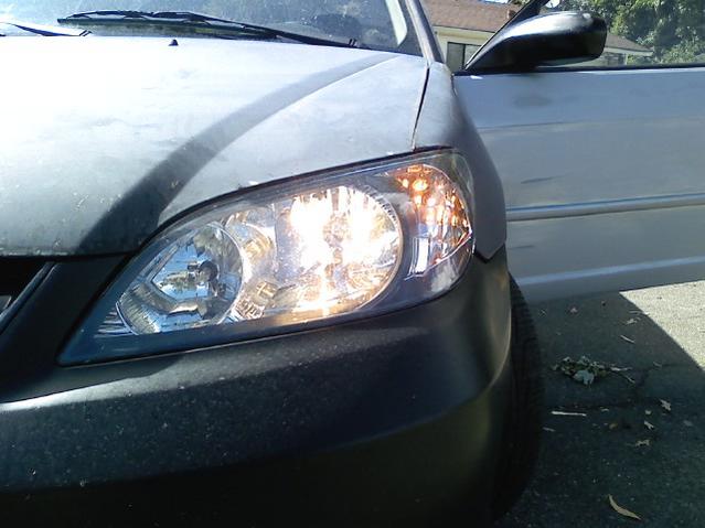

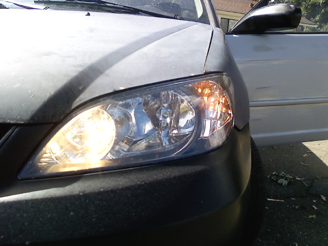

i need help on my headlight cause i need to do brake n light inspection.well my 01 civic got into a crash and i convert the front to 04-05 civic front end.and i wanna if the low beam and headlight suppose to switch off when i switch them from low or high beam or do all of them suppose to stay on.i met a guy with the same car and all his light stay on without switching so i wanna know if mines suppose to switch or not as you can see on the picture.any suggestions will help thanks.

first picture is low second picture is high beam

Re: Need help on headlight ES1
when the high beams are on (meaning the blue indicator is on, on the dashboard), then both bulbs should be on.
the highbeams are another filament in the bulb that's on in the 2nd picture
DRL's are the other filament in the 2nd picture.
Normal night time lights are exactly what your first picture is: outside bulb on and inside bulb off

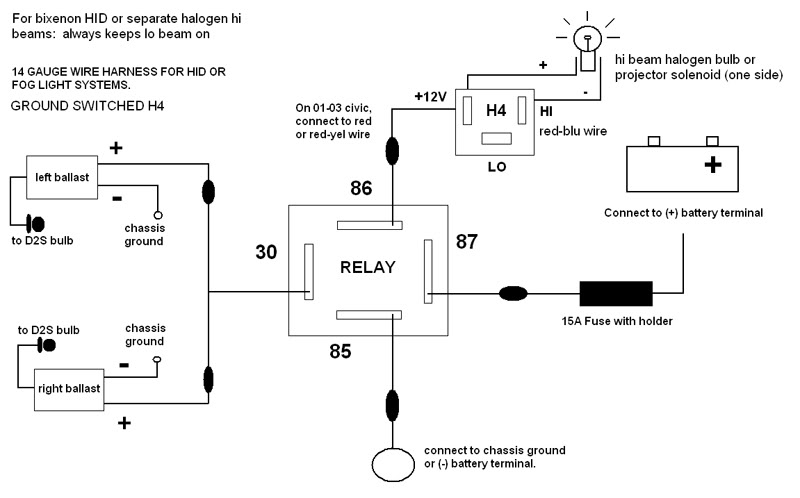

Old May 10, 2011
Rep Power: 812
you can use the diagram i made for my hid lo beams relay harness. instead of the d2s ballasts in the pic, substitute the 9006 lo beam halogen bulbs. wire the hi beams the same way as in the diagram to the stock wiring as indicated. this is for 01-03 civic so the wire colors are correct.
