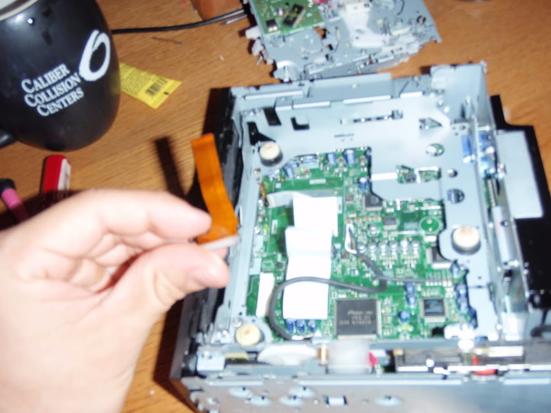

Hey guys i took some pics of my internal HU's guts for the heck of it. Its a DEH-p780mp. It kicks *** Id rather have this HU than a flip screen. I got it cheap because the guy I got it from wanted a flip screen and he said it had some rare issues of my HU screen not lighting up, but powering on. It didnt bother me any since a problem like I mentioned is usally because of a bad PCB ribbon connection, or something common like a ribbon not being in its proper position.
Anyways this problem eventually got bad enough to where it was an annoyance, so I dug into the HU to see whats up. As expected the "flex" ribbon as Pioneer calls it(flex my ***) was very brittle and literally cracked while I was checking the "flex" joints.
Just thought any pioneer owners here who have a similiar problem like mine should be aware of the dreaded flex ribbon cables. Which are common in any HU that has a motorized face....that means you flip up screens! This fix can cost around 200$, why not save some $$ and do it yourself!

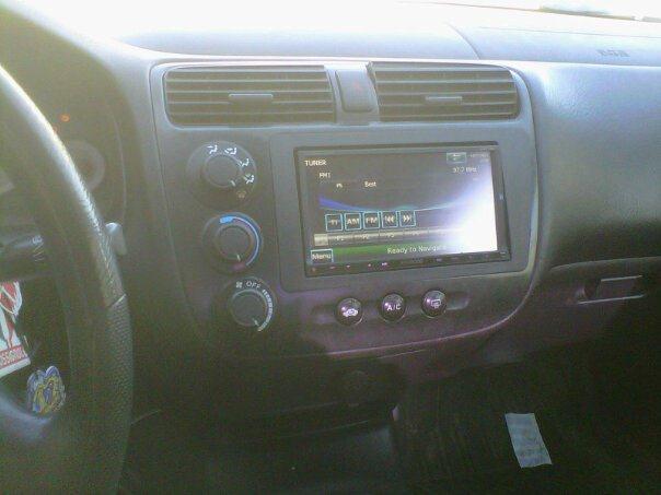

yeah i had a flip screen and hated it, it was crap, i just put a nice 7" kenwood double din in! i dont no how to post a pic of it, im new to this but ill figure it out and post a pic.

Re: If it aint broke dont fix doesnt apply here...
ID:	80218 there we go
Originally Posted by Xx7thGenxX
Attachment 80218 there we go
Thats looking pretty good, the other problem with the flip up units is that they usually block something on the dash, either vents or switches or *****, its just inconvenient.
