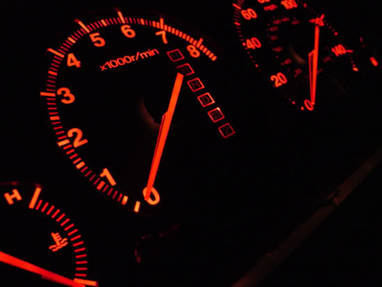

well while we're at it here I've been trying to find a way to just change the bulbs to pnp leds in the dash. I don't really want to do a cluster swap. I wanna try to get the gas and temp guages to be red and the tach and speedometer to be white (white not that greenish color). If I understand correctly, you have to pull the cluster out and use acetone on the backside of the guage face to remove that color filter, then "create you own" with paper or something? Thanks.
ps (I have an 02 civic lx)

multicolor is very difficult, mostly because the bulbs also light up the needles. and the colors would bleed together unless you are really careful with the mounting. and you would have to use extra leds for the needles since without bulbs, they wont light up anymore. you can read more in this very old diy

ok i see what you're saying. that's a really diy btw. but i was just thinking about replacing the bulbs (with pnp leds, 74's if i'm not mistaken) not removing them completely. would this work if i removed the "nasty green color" paint and used one color rather than two? Thanks for your response too!

the problem with using pnp leds is usually they are bad quality but also there will be hotspots since when you remove the painted color on the back, you also remove the diffusion grid that evens out the bulb light. provided the leds are bright and wide enough, it might work and you could use office paper to put directly over the parts that are brighter to dim it down. it will take some trial and error.
i did one cluster like that for a member who wanted the black sedan faces but with dark red backlight instead of green. so i cleared the faces with acetone on the back, put two layers of red taillight repair film, and then carefully put paper pieces on the spots that were brighter to diffuse the bulb light evenly. came out pretty good. lemme see if i can dig up some old pics of the acetone process. here are the red face gauges i did but using the stock bulbs. he wanted the evo look

awe dude that's cool. That would prolly be the route I would go I suppose. Sound's a little easier too. Yeah if you could find that, that would be awesome! Thank you

cool thats awesome man. So I would just need to get that paint off, (you said you used acetone, but did you use a cloth, a razorblade, or both?) layer tail light repair paper and maybe some pieces of office paper where the bulbs are to diffuse the brightness (of the stock bulbs)?

use qtips and change them often. you will see when paint builds up and it stops working. once you get it off, try not to keep doing the same area. just keep going. if you use too much acetone it will crack plastic. if you are keeping the stock bulbs then you can only change the color to amber or red using the respective taillight repair tapes (transparent color film with sticky backing). if using leds, leave the faces cleared.do not get acetone on the front of the gauges, it will destroy them. put the acetone on the qtips away from the gauges so you dont get any splashing. if you get lil bit on yourself its not a huge deal, but you should prolly work in a ventilated area away from open flames.
