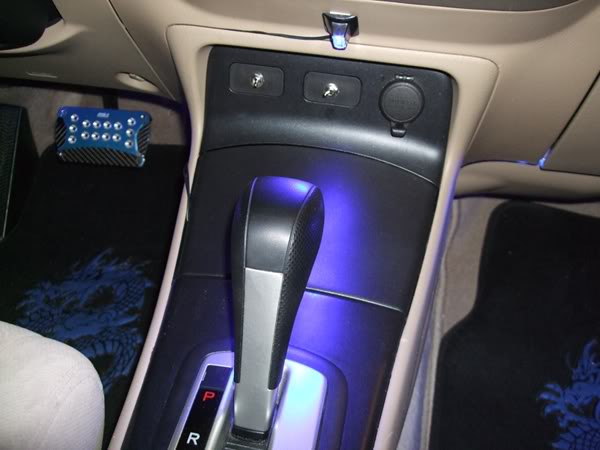

Thing is, I don't know where I should put it. He has it on his little black tab near the cup holders....
I've already used those tabs for toggle switches for all my LEDs around my car.

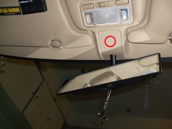

I've seen people put it on the plastic panel near the windshield

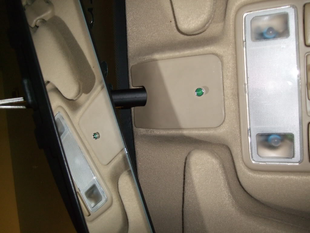

But I was thinking of putting it on the plastic clip that covers the 3 bolts that hold up the rear view mirror
I was thinking of drilling in a 45 degree angle towards the backseats and put a low emitting LED here

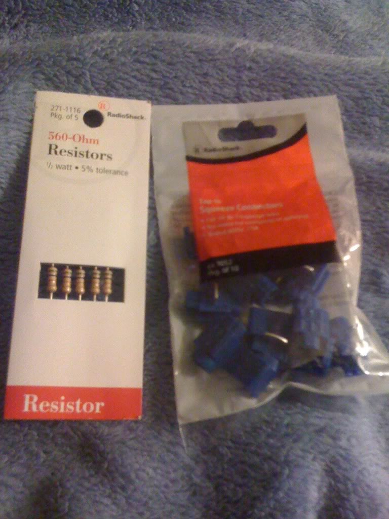

Install a higher resistance resistor in line (normal for a single 3.xV LED in 12V system ~470ohm. Use a.. 6xx ohm or so resistor), and file down the top of the LED to diffuse it more. That'll help dim down the LED more.

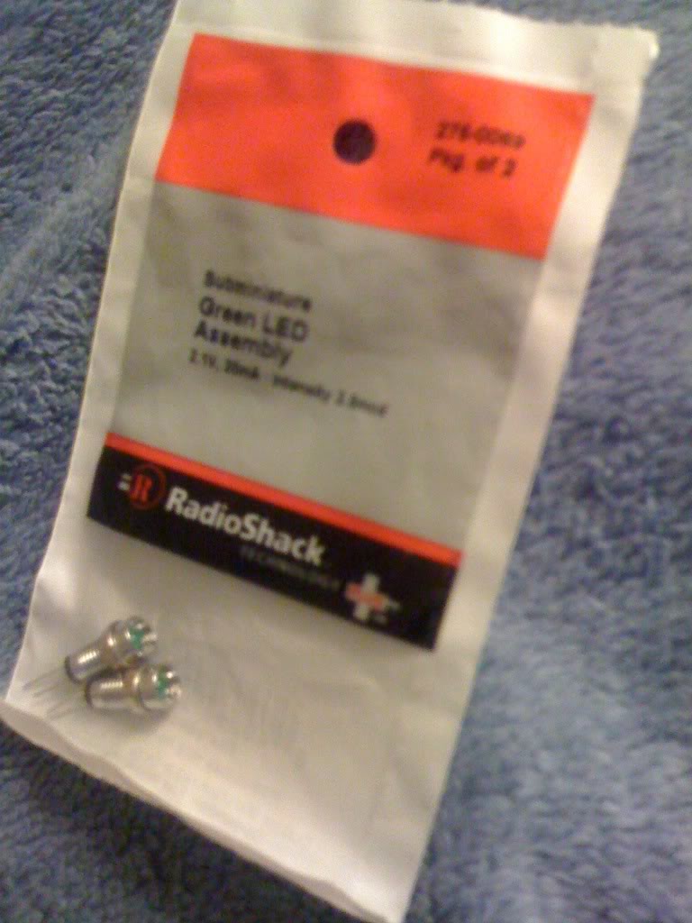

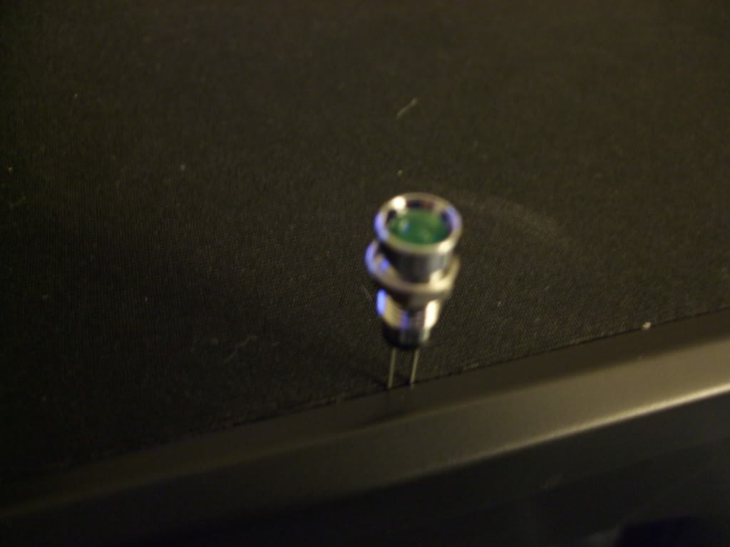

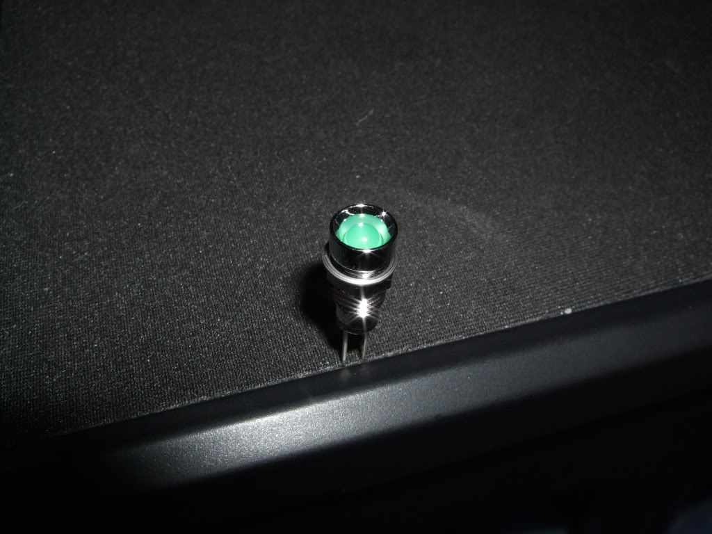

Hmmm, I actually installed it a couple days ago, i went to radio shack and found these really cool 1/4 size screw LEDs that were low emitting
Installed it and looks great
Turns out our VTEC kicks in at around 2500rpm :S
Here are the LEDs

Heres my extra materials:

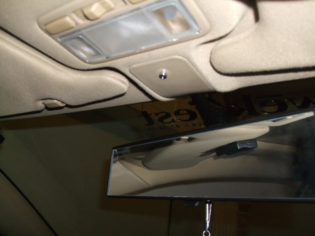

And here is the end result, very subtle, and non distracting:

Did you run the wiring across the headliner and down the a-pillar?
Old Oct 16, 2010
Kennykid2002's Avatar
Kenny the Ricer
Joined: Oct 2009
Posts: 5,580
From: In your trunk
Rep Power: 293
Re: VTEC light position opinion
Yep, since ECU is behind the glove compartment

Well, in theory, I could have routed it to back of car via driver side, through the trunk, went around the back seats, come back around the passenger side panels, and then get to the ECU....
But that takes too much wiring/effort

yeah those radioshack holders are pretty neat

holders?
you mean connectors? or the LEDs?
Old Oct 17, 2010
Rep Power: 513
holders?
I think he's talking about the silver LED grommet you used

Eh, i guess so, but that came with the LEDs on them, i like them, saves me the trouble of making the LEDs look nicer
and only 2.49 for 2
Old Oct 17, 2010
Rep Power: 513
so they did.. Lol. forgot you had a pic of the package. They do sell them separately, too, if I remember correctly.. It's been a while since I bought LEDs from a Radio Shack
