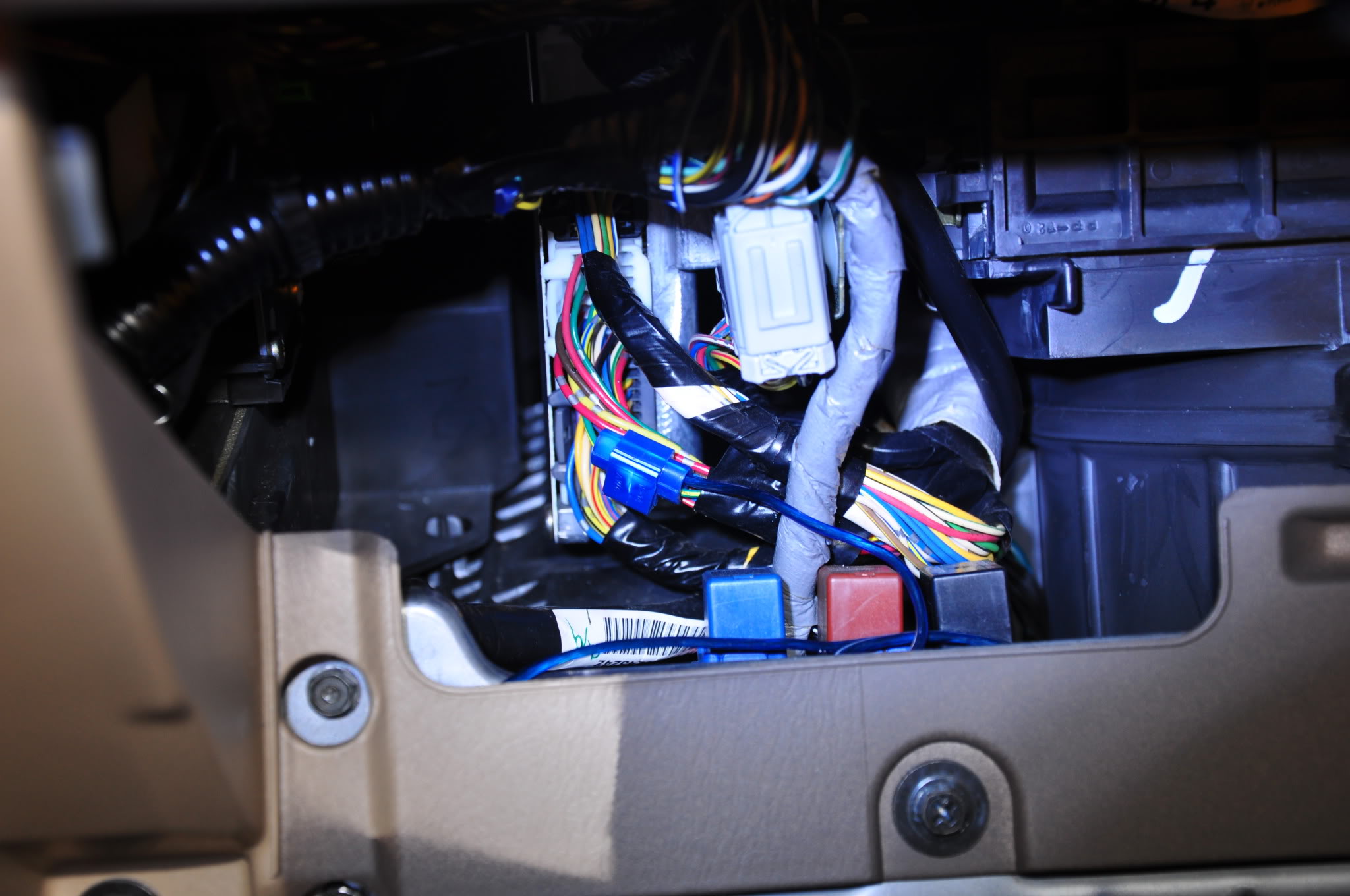

You splice into the green wire with yellow stripe
I grounded the LED on one of those bolts to the bottom left as you can see

Re: VTEC light position opinion
ok thx, I'll try it today .
Not sure I'm understanding what you're trying to say
What gray and white connectors?
sry
the LED lights from 2800 rpm to torque limiters, they would not go out before ? or normal ?
It's normal, VTEC kicks in around 2750 rpm
sry for my bad english
I thought vtec is only over a certain speed
but ok if you say that I believe you
engine speed, yes. road speed, no. it only matters what RPM.
