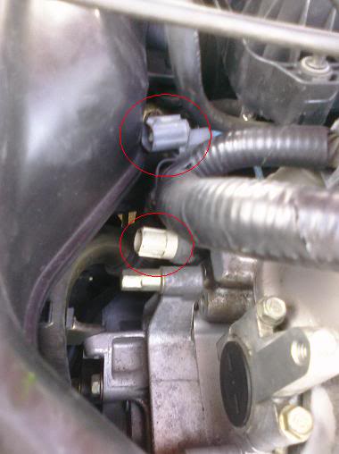

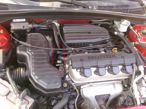

While I was trying to figure out why my AC isnt blowing so cold, I found these. What are they and where does it plug up to?

um well that is very interesting. the blue wire plug is for the vtec solenoid, and the other white connector is for the oil pressure switch. i say interesting because these are required to be hooked up for the engine to operate properly. also strange is you seem to have an LX from the header setup and not an EX with vtec. seems like someone swapped in an EX engine into your LX and didnt bother to actually hook up the vtec portion to an EX ecu. i bet your engine would run much better with that hooked up. vtec engines can run without the solenoid hooked up but were not designed to do so. its not related to the ac at all, but if you can find an ex ecu and swap it in, then manually run the wiring for the vtec solenoid, you would have an ex vtec engine working.

IF this is a EX motor, wouldn't it require a EX ecu to run it in the first place? I would find it wierd if it's being run by an LX ecu.

the main differences with the EX ecu is it includes wire inputs for the oil pressure and vtec solenoid. most of the programming is exactly the same except for slightly different shift points. vtec engine will run okay on an lx ecu, but will run even better with ex ecu. if you look for ex ecu, be sure it exactly matches the type of car you have (year, make, model, and trans type auto or manual). i think 01-03 all had the same ecu except for the trans type, and 04-05 had the same ecu. let me know your exact car info and i can help more. the 04-05 uses different oxygen sensors too.

They might have just used an ex head, meaning at some point your lx head was probably ruined. If you could look for your engine code, it should be on the front of the engine about 5 inches below where those wires you were concerned about were, it should read either D17A1 or D17a2, and that vtec head wont be running very well without vtec engaging, if you drive it hard, if you never really get above 4400 rpms or so then you probably would never know the difference. As far as your A/C goes, youre running normally, if its 106 degrees out side 76 is the coldest it will get until the air temp goes down 20-30 degrees of cooling is very normal. You should be running at 55 psi, when its that hot outside, so you could add r134a and see if it helps.

I the codes on my block says D17A1 and on my head it looks like a SOHC with code 010109256 on it.

Well you have your factory block, so at some point they had to replace your head and used a d17a2 head, like i said before if you never really get above 4400 rpms or so youll never really know the difference.

just look for ex ecu and then you can wire up the vtec.

im going to take out the stock intake system and see if the harness is there to plug up if not i might try and find an EX harness and ECU. Thank you for all the support guys.
