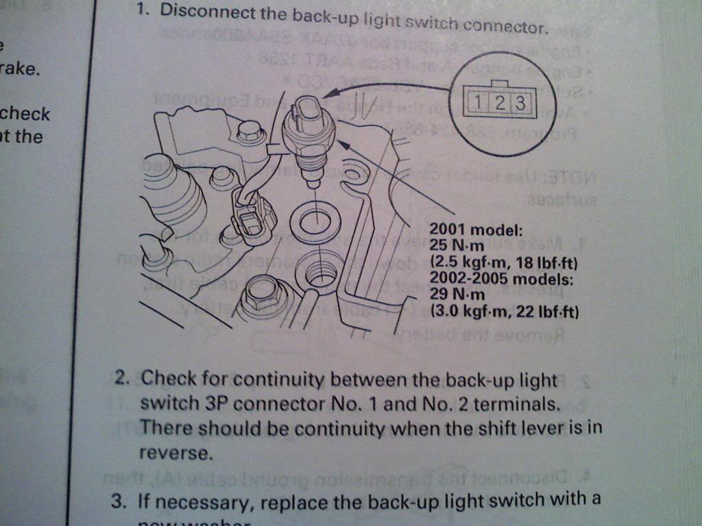

If you have a manual trans you need to check the backup light switch. If auto trans you need to check the transmission range switch.

I have a manual transmission, do you know where the backup switch is on a 04 civic?

Re: All dashboard gauges dead (04 Coupe)
It's a 3P connector on the tranny. This should help: Name:  backuolight1.jpg
