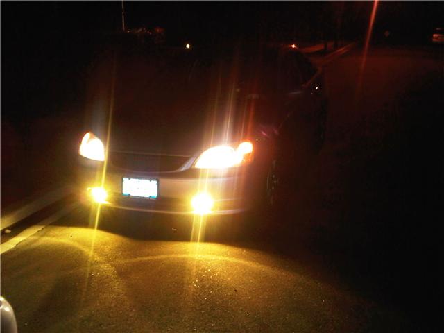

UPDATE!!!
finally got them running...i tucked the wires through the fender things by the door and under the carpet on the passanger side...i think i spliced the switch with the parking lights lol but the fogs are hooked up to the battery with a fuse and relay
soo when my parking lights go on the buttton lights up with everything else inside the car and when i press it the fogs go on YAY lol
