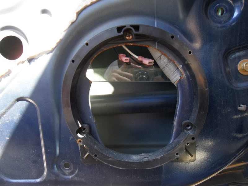

you may need to dremel out a bit to fit the front speakers (I have the Alpine SPR-17C's up front, I can't imagine the construction on the back of the speaker would be too different. Maybe the rear speakers, too. If you buy a speaker install kit (which usually comes with the spacers and whatnot that you need) they should come with tapping screws and speed nuts to mount the speakers. I was able to just use the included spacers to mount the front speaker.
Also, depending on the depth of the rear speakers, you may need to remove your trunk springs, too. I thought I had enough room with my Infinity reference speakers I got, but the magnet was too big by about ¼"
here's a pic of how much I had to shave in the front (with the spacer mounted, still). Don't mind the rust, and you can see the Honda speaker pigtail adapter I used to wire up the speaker

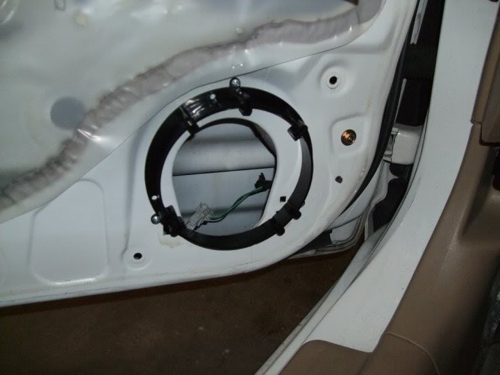

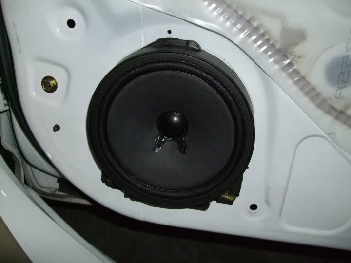

@ Riceboy
I didnt have to cut anything to fit the speaker in, instead i broke off the plastic and surrounding foam that surrounded the stock speaker in the door panel to fit the speaker in.
Stock Speaker:
Metra bracket from ebay:
Polk's installed:
