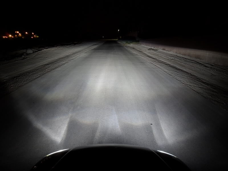

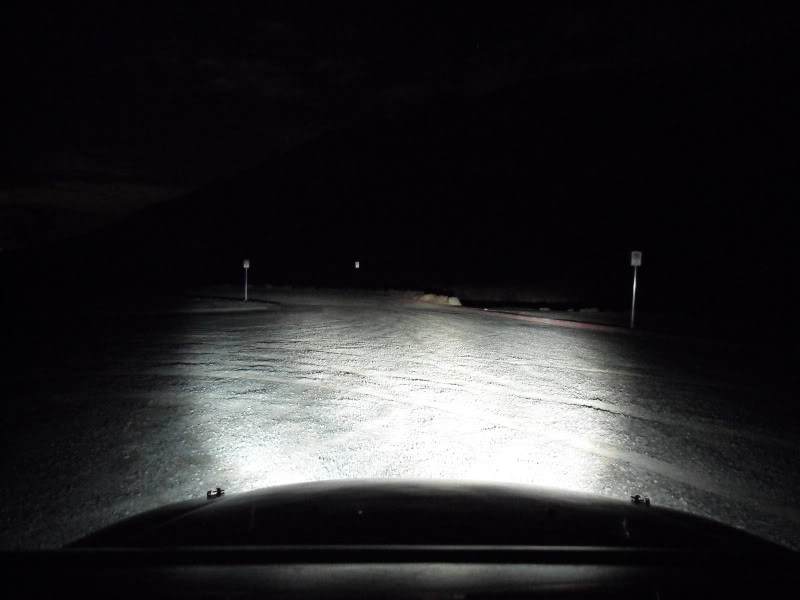

here's the light output difference for my car (top is my H1 HID kit, bottom is the TSX retrofit)
light output with the H1 HID kit
Light output with the TSX retrofit

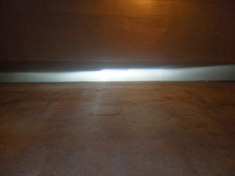

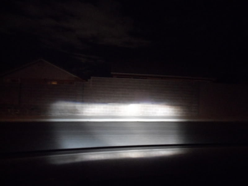

here's a comparison of the cutoffs, too
TSX Retro @ 25 feet
H1 HID kit @ ~30 feet
